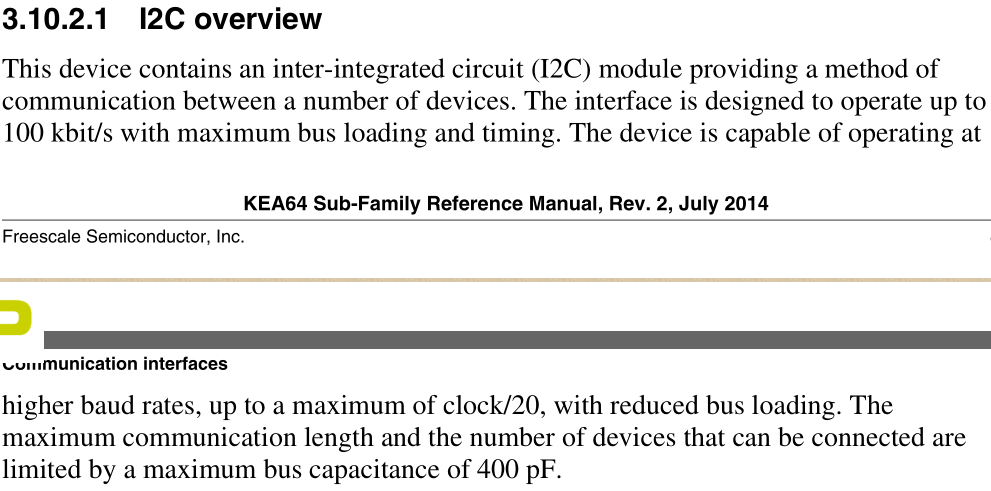

zhangzhiyong
The KEAZ128's Reference Manual description:
Our questions:
1.The KEAZ128 I2C baudrate,Can it reach 400K?
2.How to calculate the I2C bus capacitance?Is there a detailed calculation?
