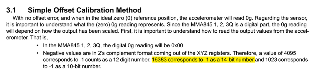

Hi I am using MMA8451Q accelerometer and its library in PE with code warrior. using MMA1_GetX(); function I am extracting accelerometer's value, so for 1g I am getting 16383 and for -1g I am getting -16383 whereas in the self calibration application note ie AN4069 I found the following information
So according to this 1g value should be 8192 and for -1g value should around -8192 and while extracting raw data from the function, I am getting values from 0 to 65,536 which I suppose it should be around 0 to 16384 . Please help me to understand how this is happening ? and also my values are fluctuating abruptly at same place i.e the reading  is varying around +/-100 values when placed on a still surface. I changed the mode from 2g to 4g and 8g but the results were same, I also used inbuilt noise cancellation feature but that also didn't help.

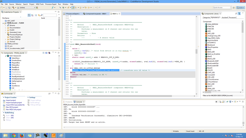

When I went to the code of the library, I found for raw x data the following code
In this code the buffer values are being shifted and hence we are getting 14 bit data so I was wandering how it is happening? So I wanted to know how these bits are being shifted to take a form of 14 bits? May be instead of leaving 2 MSB we are filling that MSB and keeping 2 LSB as floating? Due to the huge fluctuation in the values I think this may be the reason. but I dont know actually how it is happening so I am not sure of it so please correct me where I am wrong. and how to stablise the accelerometer values?

Hui_Ma
Hi Kumar,
At first, thanks Antonio for the  answer.
The MMA8451Q measured acceleration data is stored in the OUT_X_MSB, OUT_X_LSB, OUT_Y_MSB, OUT_Y_LSB, OUT_Z_MSB, and OUT_Z_LSB registers as 2’s complement 14-bit numbers.
The most significant 8-bits of each axis are stored in OUT_X (Y, Z)_MSB register and OUT_X(Y,Z) register with the smaller register address.
So, from the raw data to calculate g value, it need to combine OUT_X_MSB & OUT_X_LSB value together to a signed 16-bit variable (such as val).
Then customer can use following formula to calculate g value:  g = 1/4 * val * [resolution]
resolution for +/-2g is 1/4096;     +/-4g is 1/2048;     +/-8g is 1/1024
Wish it helps.

Hello Kumar,
Looking at the function code, it seems that it reads the 2 bytes related to X axis, and then assembles a 16-bit (unsigned) variable using the values. It shifts MSByte 8 bits to the left, and adds LSByte.
If you look at MMA8451Q datasheet, you will see that raw values are separated into 2 8-bit values. First register keeps the 8 MSbits, while the other keeps the 6 LSbits, shifted by 2 positions. Thus, when we assemble 16 bits, we have the 14-bit value shifted by 2 bits to the left. And since your return value is unsigned, the value will be represented as a positive value.
In order to transform this raw value into the value it should be, first you have to recover signal information. You may cast your variable to a signed 16-bit variable, but I am not sure if it will work. If this does not work, you have to test the variable. If it is less than 32768, you just leave it as it is. If it is equal or bigger, you have to subtract 65536 from the unsigned value to a signed variable. After correcting signal, you have to divide the final value by 4 to eliminate the 2 useless LSBits. Do not shift it right, or you will lose signal.
I hope it helps. I would post a full function to convert values, but I am on a local holiday, and away from my lab, so I cannot test the function now, and I do not like posting anything I have not tested before. Feel free to talk to me should any problems occur.
