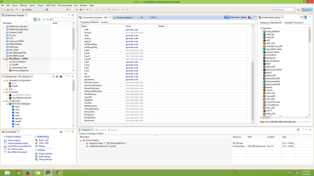

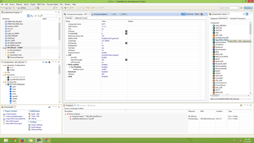

I am working on FRDMK20D50M Board I have connected SD card via SPI and I want to acquire some data to the SD card. I am having problem in Enabling some methods which are present in the FATFS library. I want to activate f_printf, f_scanf etc. but they are not being activated.
The methods are on the below snapshot
Kindly look into the matter

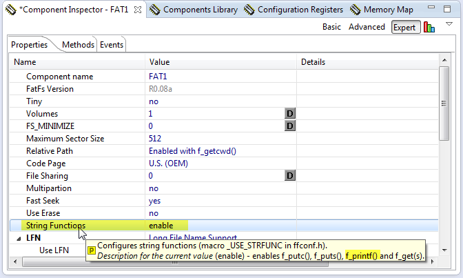

Hi Amit,
you need to enable the string functions:
Erich

Thanks Erich
It worked perfectly :smileyhappy:
