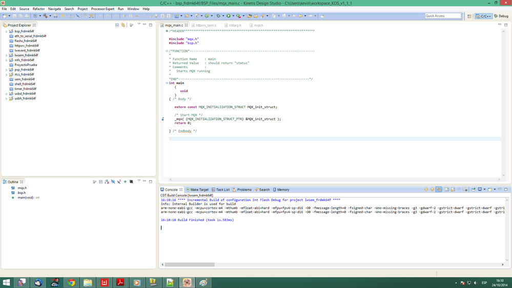

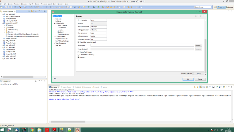

kcg
Hola David
In my console windows, not appear this information and I have checked the box 'Print size'.Why?

What version of Kinetis Design Studio are you using?  I have 1.1.1 and it reports this automatically.  Did it build successfully?  What does it say in the console window?

kcg
    I'm using Kinetis Design Studio v1.1.1 and my project is compile without errors.

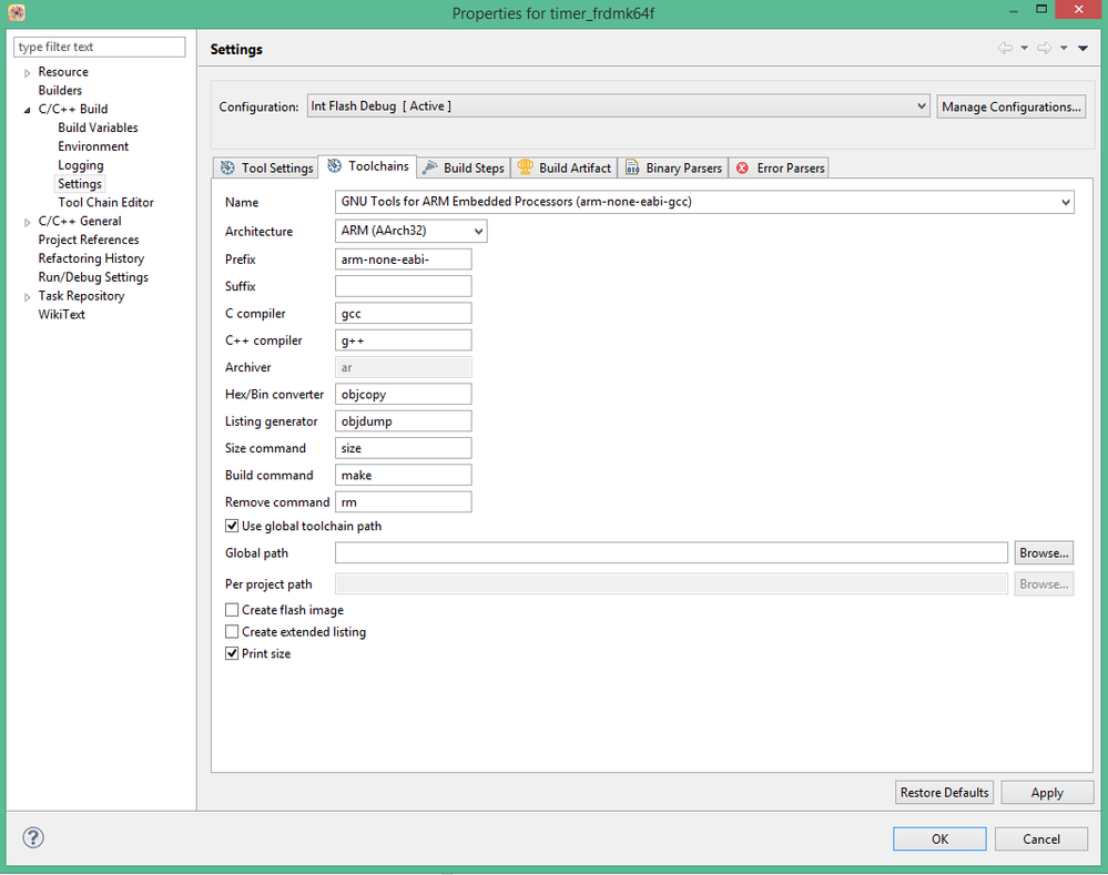

BlackNight
Hi Kevin,
you show the options for the project timer_frdm64f, while your console output is for lwsem_frm64kf?
Can you check the settings of the lwsem_frdm64kf project?

kcg
Hello Erich
Sorry i was trying different projects and I'm wrong. The same goes for this project.

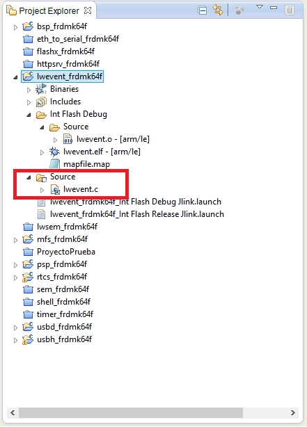

BlackNight
Hi Kevin,
can you check if you have per-file or per-folder options set in your project?
See Traps and Pitfalls: No Hex/Bin/S19 File Created with GNU? | MCU on Eclipse
This might cause a failure to call the post-build step (to print the size).

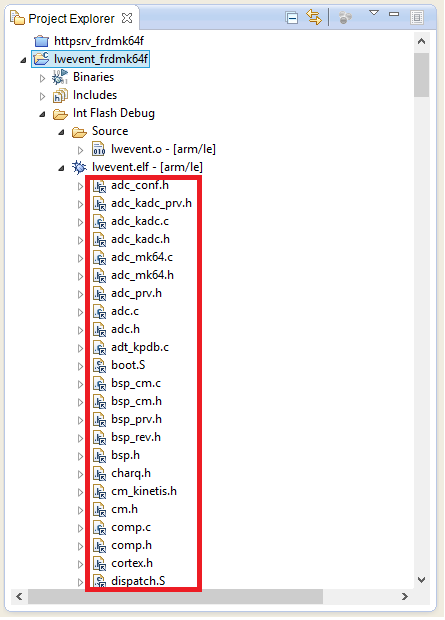

kcg
Hi Erich
Any folder has icons on it, just some files MQX indicating that it is a link to its location on the MQX diirectorio.
