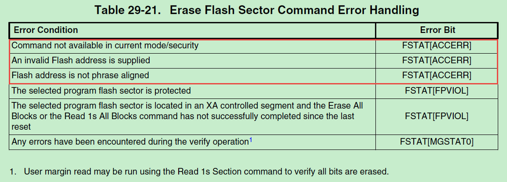

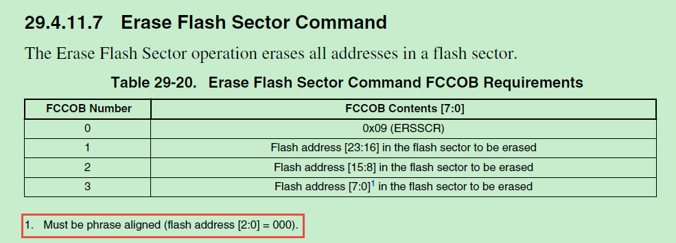

Hui_Ma
Hi Brendan,
Please check [Erase Flash Sector Command] info with K22 reference manual:
The ACCERR with below condition, please check if the provided Flash address is no phrase aligned (flash_address[2:0] = 000).
And could you check with MCUXpresso SDK for TWR-K22F120M [flash] demo, which located with below path:
..\SDK_2.2_TWR-K22F120M\boards\twrk22f120m\driver_examples\flash\pflash\iar
If that demo also with same issue on your site? Thanks.

brendanmerna
Hey Ma Hui,
I implemented the driver examples in the SDK, but its causing an error return when I try to go erase the flash. The result I get back is kStatus_FLASH_AccessError. Is there another step I need to do to unlock something.
-Brendan
