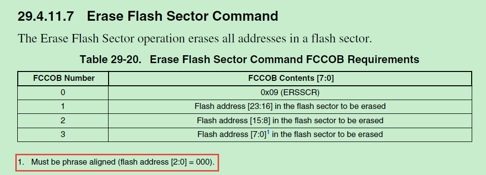

I need to write a value to the flash as a check bit for the bootloader. So the bootloader can determine whether to stay in bootloader to update the program or jump to the existing application.

Here I attached the relevant flash files that I made.
-Brendan

Hi Brendan,
Sorry for the later reply.
Please make sure the erased sector is not in Flash protection range.
Could you provide the FTFE_FPROTn registers value for double check?
Ma Hui

Ma Hui,
Do you mean the FTFA_FPROTn? Using the EmbSys Register tab in kinetis those registers are all 0xFF. Seems like that would mean nothing is protected.
-Brendan

Hi Brendan,
Please check [Erase Flash Sector Command] info with K22 reference manual:
The ACCERR with below condition, please check if the provided Flash address is no phrase aligned (flash_address[2:0] = 000).
And could you check with MCUXpresso SDK for TWR-K22F120M [flash] demo, which located with below path:
..\SDK_2.2_TWR-K22F120M\boards\twrk22f120m\driver_examples\flash\pflash\iar
If that demo also with same issue on your site? Thanks.
Ma Hui

brendanmerna
Hey Ma Hui,
I implemented the driver examples in the SDK, but its causing an error return when I try to go erase the flash. The result I get back is kStatus_FLASH_AccessError. Is there another step I need to do to unlock something.
-Brendan
