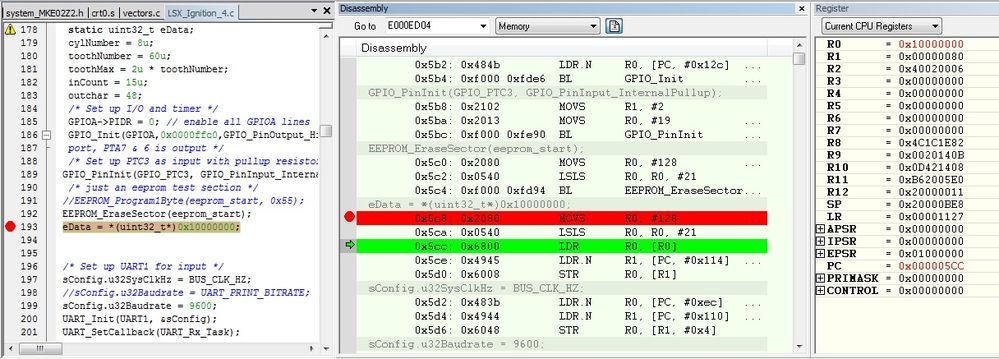

davetelling
Here is a screenshot of the section in question:
I have declared eData as uint32_t. I also tried with the eData variable a a byte and a 16-bit word, no difference (I did change the pointer definition appropriately). The disassembler shows that the EEPROM base address, 0x10000000 is placed into R0 (the first two instructions of the assembler for that line of C code)). At the instruction with the
green highlight, the value in R0 should change to the value at address 0x1000000, but instead, if I step into this instruction, it goes immediately to the default isr, with a vector of 3 (hard fault). Again, it almost looks as if there is some kind of "illegal address detector" set so that EEPROM address is not readable, but doesn't seem to have a problem with programming that same address. I am really confused by this!

mjbcswitzerland
Specialist V
Dave
The instruction looks OK but I would suggest trying the following:
1. Set a break point at the call to the erase routine.
2. Reset and run to this call.
3. Set the PC to the code after the call so that it loads R0 again with the address of the EEPROM.
4. See whether it then works.
If it does, it may man that the erase is leaving the EEPROM in an unreadable state.
After the erase operation, check the flash status register to see whether it has any flags set that indicate that something was wrong with the operation that it performed - possibly it basically did the erase but signalled an error which needs to be cleared before the EEPROM can actually be used further.
Beware also that the flash programming setting has be match the bus speed (see FTMRH_FCLKDIV) and if this value is not set correctly it can damage the Flash/EEPROM, and possiblly cause other side effects. If for some reason your bus clock is lower than 800kHz it would also be illegal for Flash/EEPROM programming. Such details are checked/regulated automatically in the uTasker driver and so I never saw what may happen in case of things being out-of-specification.

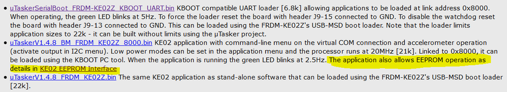

mjbcswitzerland
Specialist V
Dave
Please see highlighted text - the last one is the same but operates as stand-alone so I would load the 3rd one with OpenSDA USB-MSD drag-and-drop to the board's hard-drive if you are on the Freedom board.
You can play with the EEPROM (and internal Flash) in the I/O sub-menu on the OpenSDA virtual COM at 115200 Baud (using a terminal emulator). See the KE02 EEPROM Interface page for details of the commands.
