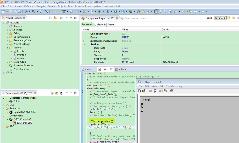

I am using DB:ConsoleIO which has an IO1:Serial_LDD component in it and was wondering of there is a getchar funciton or a way to read data from the terminal. thanks

Hi Jace Walton,
   You can use the scanf, getchar, ect.
   Take getchar as an example:
More useful functions, you can find it from the stdio.h.
Wish it helps you!
