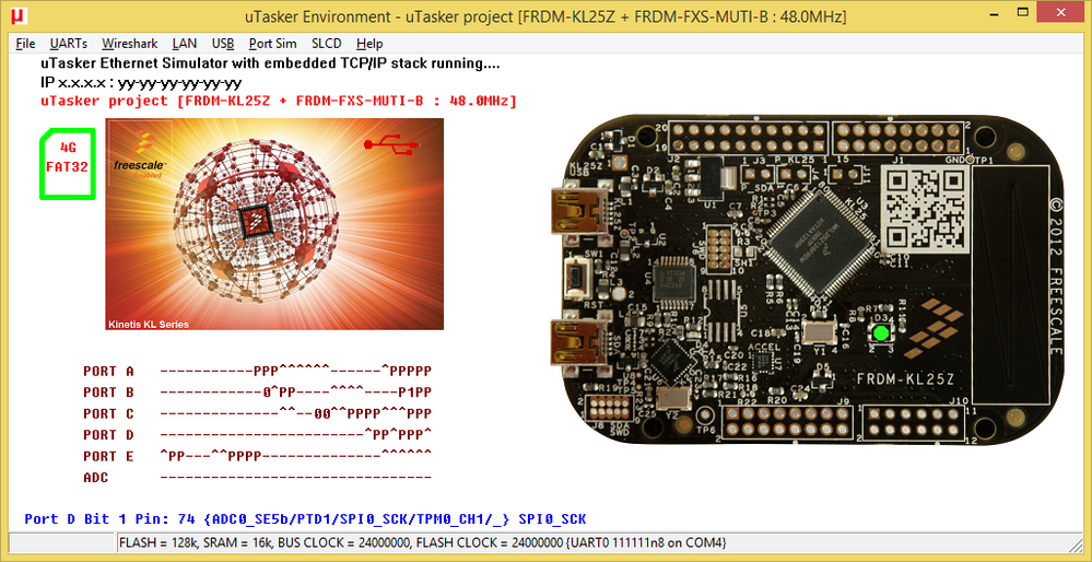

and the complete operation (FRDM-K25Z, SD card etc.) can be simulated in (approx.) real-time using VisualStudio (see screen shot below) [the free Express edition of VS2010 is adequate]. This makes it the simplest framework/tool for learning the operation and writing applications to work with it since all debugging and analysis of the operation/dehavior of the Kinetis and the SD card is performed on the PC with VisualStudio.

The binary can be built with almost any IDE/compiler (although the GCC cross compiler step is also automated in VS for simplicity):
It can also be used with any other Freedom boards without any porting effort since it adapts itself to all K, KE, KV and KL chips/boards.
All software and tools are free for educational use and supported in this forum.
