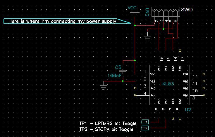

I'm still trying to put my KL03 to VLPS mode. After the WFI instruction, I can see the STOP bit set. So, I think that something is aborting the device's stop procedure.
1) Is there some way to know what is aborting it?
2) what's the right status for FTF bit at SIM_SCGC6?
My main problem is that the MCU don't reach low power consuption. I need it working under 10uA, and on VLPS it should drain only 2.2uA.
I'm looking forward some tips...
Thanks and regards...

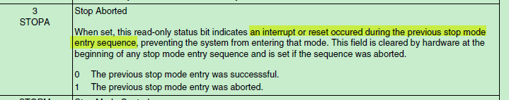

    1. Is there some way to know what is aborting it?
   Answer:You need to know why the STOPA is setting, please check the reference manual register description.
As you know, the VLPS entry need time, but in the entering stage, you have a interrupt or reset happens, the VLPS entry will be failed.
Check your watchdog, did you disable it? watchdog may caused reset.
Another point: interrupt, this may the top reasons caused your STOPA set problem.
Please check your code, what interrupt you are enabling?

Answering your questions, I have LPTMR0 interrupt each 1 second. I don't think that the MCU spend more than 1 sec to goes to STOP mode, do you agree? Thats the only interrupt that is enabled. The whatchdog is disabled, all the ports is disabled, IRQs, TPMs, UARTs, I2C, SPI, everything disabled.
My board has only the MCU, the 100nF capacitor between VCC and VSS, and the SWD connector assembled. All the MCU pins are floating on the board. I'm connecting an external power supply at 2.8Vdc directly on the Vcc point, with a multimeter in serie.
According to the debugger, I'm downloading the code, power it off, removing the debugger and power it on again.
Another comment is: I read in some article that to ensure that the debugger module is off, we must to secure the device. I've checked the FSEC bit at FlashConfig register and the default value is FE (unsecure). I already tried to change it to FF (secure) but the power consuption is still the same.
Attached my simple test code and the schamatics of my board.

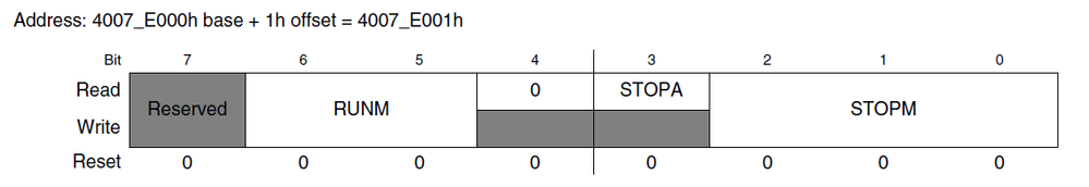

Checking with the debuger, I can see the value 0x22 at SMC_PMPROT register, so it's ok. Actually, it's loading before my code starts, but with the same value that I should load.
Another important informatio: when I clear the FTF register before goes to VLPS mode, the current is around 33uA (close to the VLPW current). When I didn't clear this bit, the current is around 190uA (close to Normal Stop current).

kerryzhou
Hi Ivan,
Thank you for your detail information.
1.    PTB5 is the NMI pin, you need to add external 4.7K to 10K pull up resistor, please add it at first.
2.    The project link, I can't open it. Please attached it directly, I will test it directly on my board.
Kerry

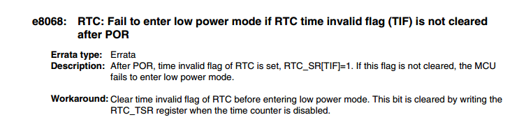

Finally I found the solution, and I would like to share with you that was trying to solve it with me...
After more that one week reading all the docs, ans, codes, libs, etc... one of the NXP engineers answered me an e-mail that, when I read, I thought: thats the answer. Actually, all the regular documentation don't show the real problem because it's a mask bug. There is an errata (http://www.nxp.com/assets/documents/data/en/errata/KL03Z_1N86K.pdf ) that explain on the topic e8068 the real problem.
Even don't using the RTC, you must set it's clock gate, and then, be sure that it is disabled clearing TCE at RTC_SR and then, write any value to RTC_TSR to clear the bit TIF of RTC_SR.
Look what this errata says:
T
That's the problem to enter in Low Power Modes!!!
Thank you very much for the patience and I hope to help another NXP users to resolve this problem quickly.

#elif defined MASK_1N86K
    #define ERRATA_ID_8060   // ROM: bytes sent from host over I2C and SPI interfaces may be lost
    #define ERRATA_ID_8058   // ROM: COP can't be re-enabled in application code due to being disabled by ROM boot code
    #define ERRATA_ID_8086   // ROM: fail to setup connection by UART interface if RX pin is low after POR
    #define ERRATA_ID_8059   // ROM: using UART at 57600 bits/s or greater with a core clock of 8 MHz may cause lost bytes
    #define ERRATA_ID_8068   // RTC: fails to enter low power mode if RTC time invalid flag (TIF) is not cleared after POR
    #define ERRATA_ID_8085   // TPM: writing the TPMx_MOD or TPMx_CnV registers more than once may fail when the timer is disabled
and the workaround automatically switches in as follows:
    #if defined ERRATA_ID_8068 && !defined SUPPORT_RTC // if low power mode is to be used but the RTC will not be initialised clear the RTC invalid flag to avoid the low power mode being blocked when e8068 is present
    POWER_UP(6, SIM_SCGC6_RTC);       // temporarily enable the RTC module
    RTC_TSR = 0;                      // clear the RTC invalid flag with a write of any value to RTC_TSR
    POWER_DOWN(6, SIM_SCGC6_RTC);     // power down the RTC again
