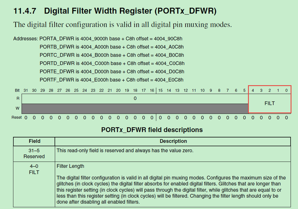

I am seeing in the latest Reference manual of K70 series controllers, K70P256M150SF3RM Rev. 4 (Page 5-7), a new set of port configurations available for digital filters used to filter out glitches. How a single bit in register PORTx_DFWR is used to select filter width?PORTx_DFWR‌ #glitch digital filter k70 #debounce

The K70 reference manual (K70P256M150SF3RM Rev. 4 (Page 5-7)) with incorrect PORTx_DFWR register info about [FILT] bits. Please check below picture for the correct info:
I had reported this document issue. Sorry for that document error may bring any inconvenience.
