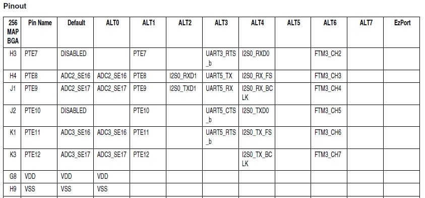

I'm confused as to how to read the signal multiplexing and pin assignments tables in the product literature. Please refer to the attached image for reference.
Is the port controller used to set the pin configuration for all pins at once, based on the ALT0, ALT1, etc parameter?  Eg, if mode "ALT2" is set, is pin H3 used for anything?  Or, can the function of an individual pin be set independently of the others?  Eg, could I set H3 to PTE7 and H4 to ADC2_SE16?
Thanks for your assistance.

Hi Scott,
Each port pin has its own Pin Control Register (PORTx_PCRn).  These can be found in the "Port control and interrupts" chapter of the respective reference manual.  In this register there is a 3-bit MUX field that is used to assign the selected port to the desired functionality, as shown in the table which you point out.
In your example, the corresponding Pin Control Register for PTE7 (located on pin H3) is PORTE_PCR7 (located at address 0x4004_D01C).  For this specific pin, the MUX field options are:
  000  -  Pin Disabled
  001  -  PTE7
  010  -  n/a
  011  -  UART3_RTS_b
  100  -  I2S0_RXD0
  101  -  n/a
  110  -  FTM3_CH2
  111  -  n/a
