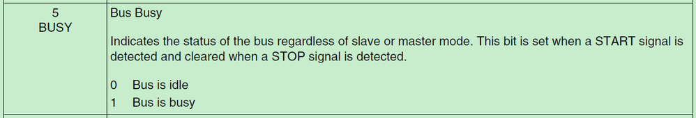

You can use the I2Cx_S[BUSY] bit to check if the current I2C communication continue or stopped.

Hi  I also noticed this bit , but I am still confused about its usage. Currently the  kinetis CPU in I2C slave mode  receives data through the I2C interrupt , if I want to whether it is the last bit,  is it suppose to check this bit after receiving every byte?
or after receiving every bit , wait for some time , and then check this bit in the interrupt ?

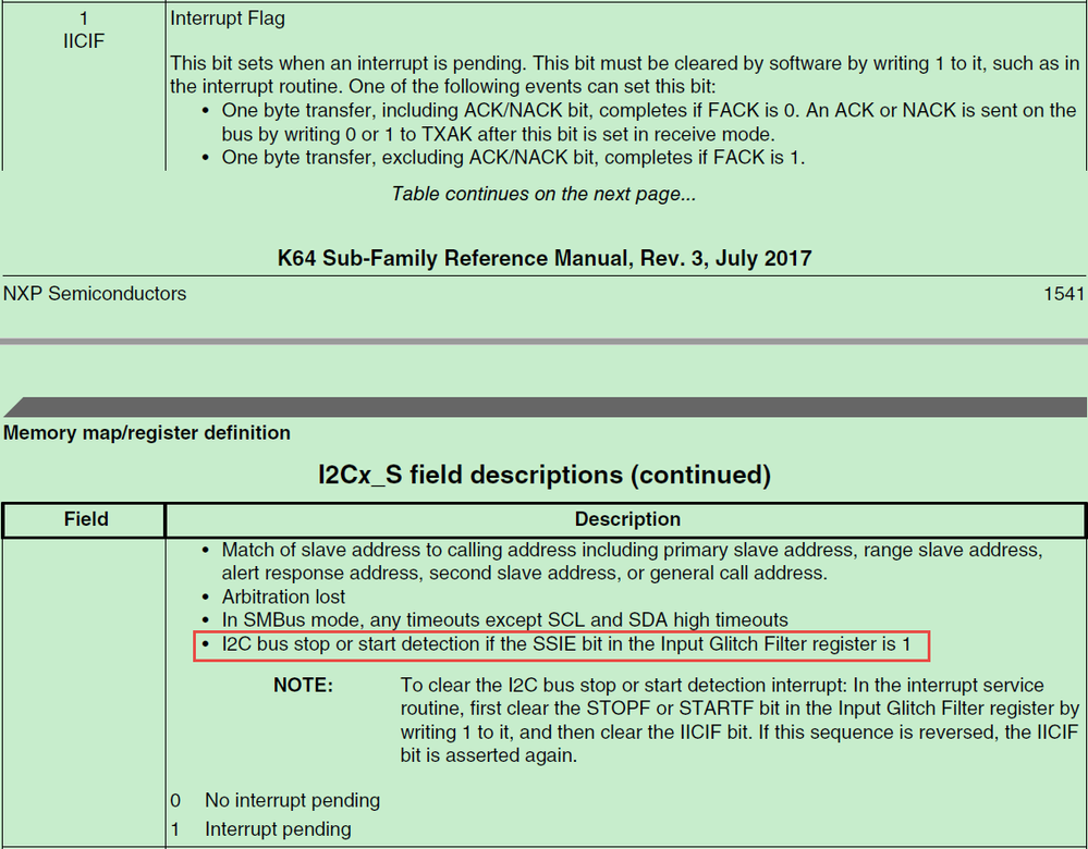

I checked the updated Kinetis product(such as K64 chip) I2C module provides STOPF flag for last byte checking.
While, based on current I2C module, I would suggest after each byte received, waiting for 2bit time to check the BUSY bit status. The BUSY bit checking routine should be out of the I2C interrupt service routine. The waiting time (2bit I2C) could use a timer to generate related timer interrupt, then in timer ISR to check the BUSY bit state.

thanks for your suggestion, I am using KINETIS K10 , which doesn't have
STOPF flag. And I tested checking the BUSY bit in the i2c interrupt
routine after receiving last byte , seems it failed . So as your

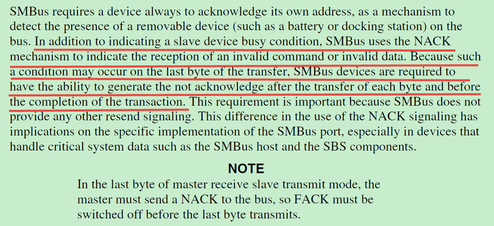

The I2C slave could use NACK to completion the transaction.
Please check below description at K10 reference manual:
I would recommend customer to set I2C Slave receiver data buffer with fixed number. When received byte number equal to the Max. RX Buffer size. I2C Slave need to send NACK to completion the transaction.
Then I2C master will know, the I2C slave couldn't receive any more bytes and stop the current transaction.

Yes, the K64 I2C module STOPF bit will trigger the I2C interrupt, please check below description about I2C interrupt flag:

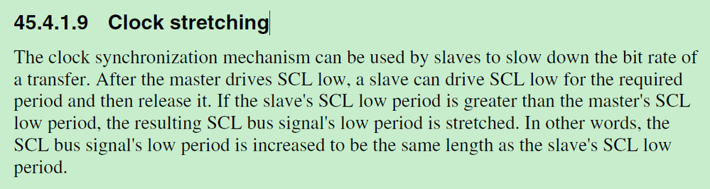

You can use clock stretching feature at I2C Slave code.
Here are more details on I2C clock stretching.  I2C is a bi-direction open-drain interface, always clocked from the master.  But the slave can also drive the clock line low, delaying the clock edges as needed, and therefore stretch the clock period.  This use case is when the master first writes to a slave on the bus, and uses the read command.  The master then provides the clock edges for the read, and the slave is supposed to respond with its data during those clock edges.  If the slave is not ready to respond when the master expects to receive the data, the slave can drive the clock line low and stretch the clock until it is read.
How to use clock stretching?

When I2C master want to read data from slave, if the I2C slave doesn't write any byte to I2C Data I/O register (I2Cx_D), the SCL line will be hold low with I2C slave. Then I2C master will know I2C slave is preparing the data (clock stretching happens). From I2C slave aspect,   I2C Slave only written I2C Data I/O register (I2Cx_D) when the data is ready.
