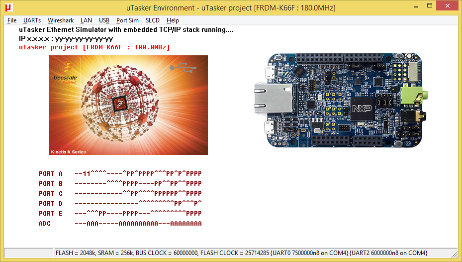

I don't see any problems with 6.0M or 7.5M Baud rates.
Thsi is the uTasker simulator showing the achieved baud rates when UART0 (clocked from system clock) and UART2 (clocked form Bus clock) are defined for these speeds:
As reference, the register values are:
UART2 (bus clock = 60000000Hz) Divide =0 ; fraction = 0x14 -> 6.0MBaud
UART0 (system clock = 180000000Hz) Divide =1 ; fraction = 0x10 -> 7.5MBaud
Mark
