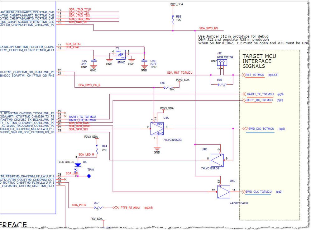

I recently bought the KE06Z dev board. It seems to be powered at 3.3V by default but I really want 5V GPIO's (I picked this board for this capability).
Can anyone advise if the board can be modified to run at 5V? I see in the user's guide there is J14 which switches voltage, but what other modifications would I need to make and is this really advisable? I also note that the IO pin jumpering also takes into account 5V compatibility for some pins (duplicate mappings).

My plan would probably be to solder a header to J14, insert a jumper, and then I would need to remove R76 (0Ω jumper by my reading).
That just leaves the schematic reference, "When 5V for KE06Z, R45, R42, R52, R72 and R74 must be DNP. As these connected pins are not 5V compatible." If I read right, removing those resistors would simply leave the pins completely disconnected. But I could just avoid using (a 5V signal) on those pins?
I will still want to use OpenSDA.

Robin_Shen
The SWD_DIO_TGTMCU and SWD_CLK_TGTMCU is connect at 74LVC125ADB. From the datasheet of 74LVC125ADB we can know: 5 V tolerant inputs/outputs for interfacing with 5 V logic.
Not sure if you still want to use the UART of OpenSDA. UART1_TX_TGTMCU and UART1_RX_TGTMCU are connect to the PK20DX128VFM5. These two pins can not directly connect to 5V KE06Z.
RST_TGTMCU can not directly connect to 5V. But you can use the SW1 reset KE06Z.

Hi Robin
I've removed R52, R45, R42, R72, R74, R76 (J14) and installed a header at J14 that I can jumper for 3.3 or 5V.
I've tested the board at 3.3V and everything seems fine. I even get the debugging console (which I was wrongly expecting to be killed by the cut to the UART TX line).
This leaves me with only 2 questions: Firstly R37 - you can see in your schematic snippet that it goes between the OpenSDA controller and the main MCU, unbuffered. It seems that it's not safe to leave this resistor in place. Can you confirm? I didn't just go ahead and remove it because I wasn't sure what it's function was. I won't test the 5V configuration until I understand if it needs to be removed.
Secondly you say that RST_TGTMCU cannot be connected to the 5V MCU, but as an input pin, this should not matter? Shouldn't retaining R35 still work (even if out of worst case tolerance) because the 5V MCU should still read ~3.3V as a reset high signal?

Robin_Shen
1.
I don't understand it's function either.
Considering on board OpenSDA(SWD CONNECTOR J7) can be used to debug custom board, I think you can remove R37.
Below information maybe useful for KL26\KL25: If you have a FRDM-KL26Z board and load the mbed debugger (rather than the P&E one) it generates a 32kHz input for the RTC_CLKIN (see SDA_PTD6 and R22). this is useful for preparing SW for designs that later have an external clock generator.
2.
For the RST_TGTMCU(PTA5 KE06), it does not matter connect 3.3V to this Reset_b function pin.
But for the SDA_RST_TGTMCU(PTB1 K20), output pin can't direct connect to 5V. The Kinetis Port pins are only 5V tolerant as inputs.  The outputs are not 5V tolerant, and that includes pins configured as open-drain outputs. In output mode, if the pin is pulled above VDD, it will cause the output buffer to drive the output at VDD, which will pull-down the pin voltage to near VDD.

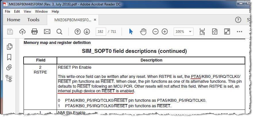

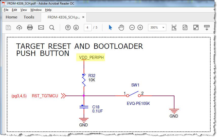

Robin_Shen
The internal pullup at PTA5 of KE06 and the external pullup through R32.
K20 open drain output must not be pulled above VDD(K20).
