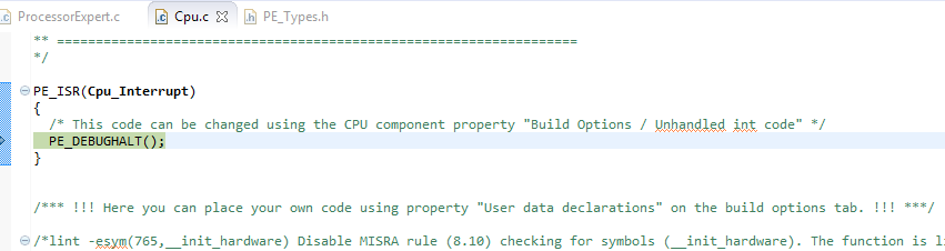

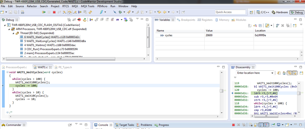

arunkumar1989
Hi Erich,
I forgot to mention this to you,when debugging i observed some odd things :
The code hangs at this particular ISR.
After a little digging , found out that this was linked to the RTC settings.
So when i disabled the RTC Oscillator.So i disabled the RTC module from PE,the code moved forward,but again hit a snag.
Now its hanging at the WAIT1_WaitCycles loop
So for a temporary solution i disabled all the wait functions in processorexpert.c and moved forward.
Next ,whe i ran the debugger ,it hanged at
digging further into CDC1_App_Task(),i found that it was returning the ERR_BUSOFF (as you can see from above)
Could you shed some light on this error please?
Also i matched my crystal pins with the tower board reference circuit,but still the same result..
8,965 Views

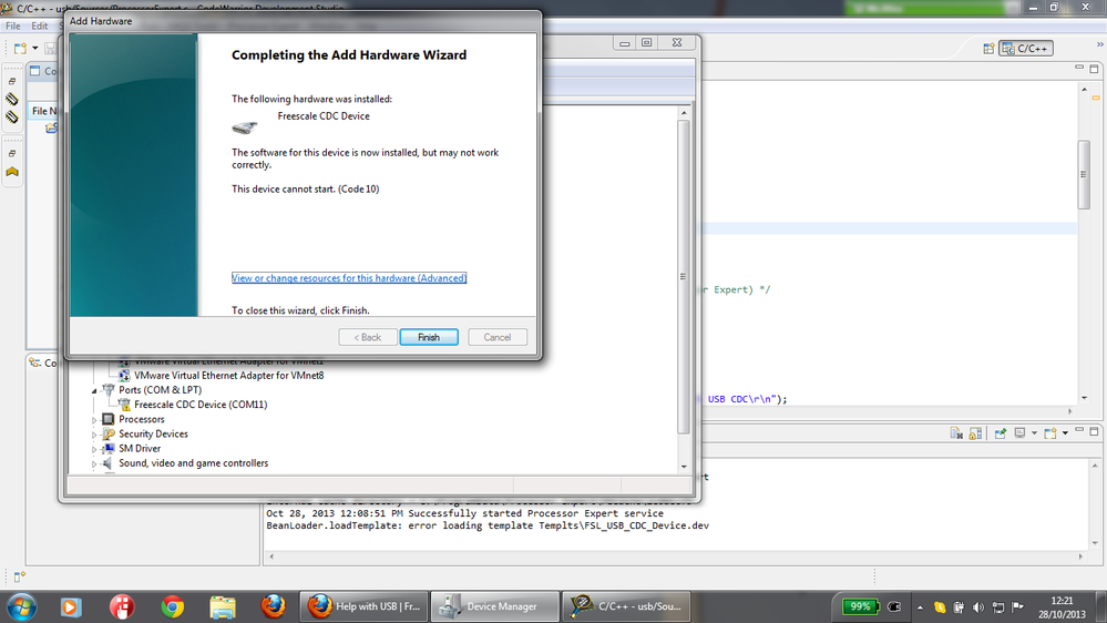

arunkumar1989
Hey Erich,
I tried but i think its not working correctly.
Let me run you though it one tiny step at time. -;),perhaps you may find what i am doing wrong here:
1.I was able to program the controller successfully with the new code.
2.Then i connected my cable to my hardware first ,then the PC side usb port
3.No change or hardware detected in device manager.
(Running on win 7(32 bit) by the way)
4.In device manager,
I click Action->Add new legacy hardware->next->select the "Instal the hardware that i manually select from the list(Advanced)"->i select PORTS(COM & LPT) and click next->click on "Have Disk"-> a window pops up from which i point it my the cdc.inf file->Model i select as "Freescale CDC Device" ->click next->click next->windows warning appears(click install anyway)->finally i get a "Completing add hardware wizard" with a code 10 error .
8,969 Views
BlackNight
Hi Arun,
Has that 'Freescale CDC Device' shown up automatically in your device manager? I see it in your screenshot, but your text tells me that the device manager did not 'see' it automatically?

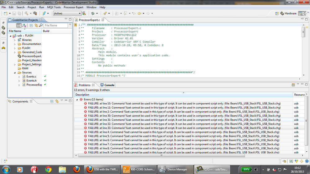

arunkumar1989
Hi Erich,
I am getting a bunch of errors after doing all the changes,any idea what may be causing this ?
And it is able to generate the .afx file in-spite of the errors being generated. !!
8,969 Views
BlackNight
Hi Arun,
this is 10.3, right?
Have you loaded the latest (released yesterday) *.PEupd files from GitHub?
Try close the project and open it again (project > close). Maybe the problem goes away. It might be one of the issues of 10.3 I was aware of (that's why 10.4 is much better in my view).
If this still does not help: can you post your project?
Erich
