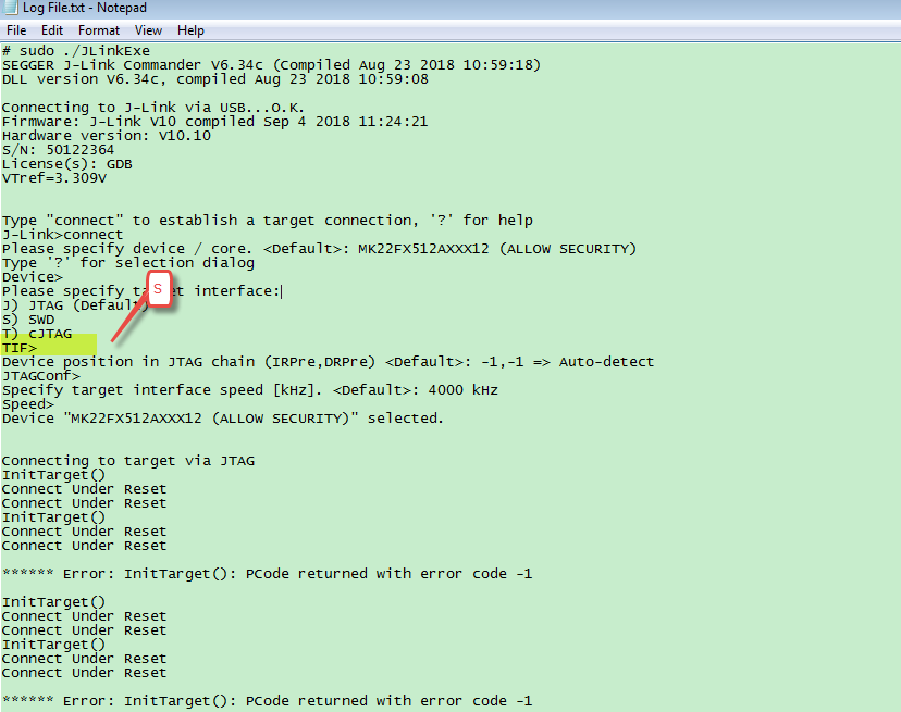

We are using a Kinetics MK22FN512VLL12 MicroController for the first time, on a pcb that we are bringing up.. We cannot connect to the processor's SWD interface. We are using a Segger J-Link adapter for the board bring-up SWD interface... with J-Link Commander software (Windows 10). When connecting to the SWD port using the Segger, there is a light on the J-Link (normally green) that turns orange, and we receive connection errors in the Commander software.
I have attached the log file and schematic for our design.

     I have checked your schematic and your JLINK commander log, I find in your schematic, you have the JTAG and SWD interface, please tell me what the interface you have used?
 If you are using SWD, then in the JLINK commander, you need to input s, to select the SWD interface.

Thank you for your reply, and apology for the confusion: The previous log file we sent was from a JTAG attempt at connecting to the CPU, but as you can see from the SWD log below, the SWD behavior is similar to the JTAG output.
The questions we have are:
  1. What conditions would cause the J-Link to not be able to connect, or to attempt to connect using the “Connect under Reset” protocol. The J-Link documentation implies that “Connect under Reset” is typically used with STM32 processors.
   2. The J-Link indicator light is orange when connected to the SWD connector. This would seem to indicate that the                processor either cannot be reset or cannot be HALTed. Since the RESET line is behaving correctly from the scope          trace we sent, what conditions would keep the processor from being halted?

# sudo ./JLinkExe
SEGGER J-Link Commander V6.34c (Compiled Aug 23 2018 10:59:18)
DLL version V6.34c, compiled Aug 23 2018 10:59:08
Connecting to J-Link via USB...O.K.
Firmware: J-Link V10 compiled Sep 4 2018 11:24:21
Hardware version: V10.10
S/N: 50122364
License(s): GDB
VTref=3.311V
Type "connect" to establish a target connection, '?' for help
J-Link>connect
Please specify device / core. <Default>: MK22FN512XXX12
Type '?' for selection dialog
Device>
Please specify target interface:
J) JTAG (Default)
S) SWD
T) cJTAG
TIF>s
Specify target interface speed [kHz]. <Default>: 4000 kHz
Speed>
Device "MK22FN512XXX12" selected.
Connecting to target via SWD
InitTarget()
Connect Under Reset
Communication error while accessing MDM-AP.
Connect Under Reset
InitTarget()
Connect Under Reset
Connect Under Reset
****** Error: InitTarget(): PCode returned with error code -1
InitTarget()
Connect Under Reset
Connect Under Reset
InitTarget()
Connect Under Reset
Connect Under Reset
Cannot connect to target.

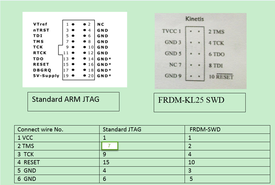

   This problem mainly caused by these points:
1. Check the SWD connector to your JLINK JTAG interface, you must make sure the connection is correct.
You must make sure your connection is correct!
2. About the hardware solder temperature, it is about 270 degree, high temperature may damage the chip.
3. When you select the chip, please choose MK22FN512XXX12 <allow security>
  Then, when you meet the problem, you can input: unlock kinetis
  Then connect it again.
  If still have the connect problem, I am afraid your hardware or solder have the problem, you can try another board, when you solder the chip, please control the solder temperature.
