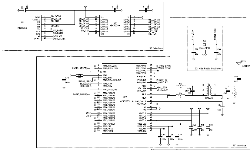

nikivendola
This is the complete schematic of the MC13233:
It 'possible that picks up the clock of the Radio Oscillator (X3)?
This other is the complete schematic of the board:
How do you see the IIC appears in many parts and it seems strange...
The designer of the card can not help me because he had designed years ago and left the university after a year of contract just finished this card....
5,417 Views
AngelC
Senior Contributor I
Hello Niki,
Yes, the MC13233 has its own clock (X3) as it should and therefore you will be able to use only UART and interrupts as you plan.
Furthermore, the IIC bus appears many times because it is shared by the MC13233, some sensors and what seems to be an audio codec, this is also OK. The TPM was used with the MC13233 for a specific reason, but I could not determine which one. If you will not use it, then you could simply ignore that.

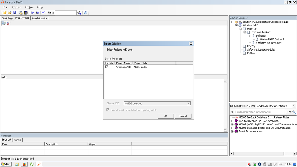

Hi AngelC,
When complete the procedure of implementation of a project with BeeKit and I want to export it from me: Project Are Not Exported. Why?
I can export it anyway. But, after importing of KDS and I: "Convert CodeWarrior project files ..." nothing happens ...
Support Engineers can follow the most?
