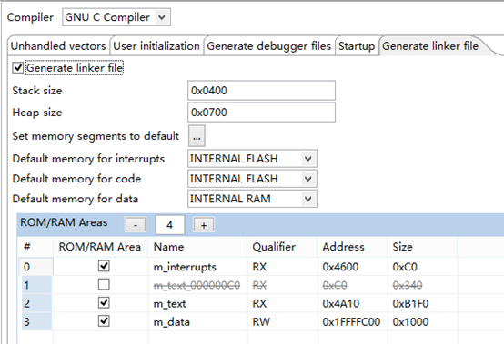

I designed an embedded software (written in C++ and almost all C++ objects are dynamically linked using heap) targeting on MKE02 MCU(64KB Flash with 4KB SRAM), but it has a serious bug causing hard fault occasionally.
This is a bug when the code size and data size of the application software approaches its maximum, and corruptions of data structures created by "new" operator were observed before. I had to upgrade the MCU from MKE02Z32 (32KB Flash with 4KB SRAM) to MKE02Z64 (64KB Flash with 4KB SRAM) because of this bug recently, and this upgrade did solve the problem.
Unfortunately, the application size is now getting big enough to hit the bug again. In order to find a complete solution for this bug, please help me understand more about the runtime memory map of this MCU.
As shown in the snapshot (from ProcessorExpert, KDS 3.0 platform) below, the starting address of the software is 0x4600 with max code length of 0xB1F0, the code space ends at 0xFBFF, 0xFC00 - 0xFFFF is used for data storage, and 0x0 – 0x45FF is used for a bootloader designed by ourselves.
The result from compiler (with optimization level –O0) and linker is as below:
Text 42760  data 140  bss 3584  dec 46484  hex B594
The map file and linker file are attached.

based upon above information, now I have questions below:
  1.        Why the heap addresses defined in the map file (0x1fffff80 – 0x20000680) are different from that returned by         _sbrk(0) (0x200003B8 – 0x20000864)?
  2.        Why the Stack address has different definition in the map file (0x20000a80 vs 0x20000c00) while startup.c loads     0x20000c00 into SP?
  3.        How to safely get the stack pointer while application is running?
Thanks a lot for any replies.

It might depend on which ARM toolchain (or library) you are using, so it might be helpful to share which IDE you are actually using.
One thing to note is that by default the stack and heap are growing towards each other: which means that the stack could potentially run into the heap and the heap could potentially run into the stack. Depending on your sbrk() implementation, you might get a fault there (see FreeRTOS, malloc() and SP check with GNU Tools | MCU on Eclipse).
About your questions:
1) I assume you are calling indirectly some constructors already (in the startup code)? Then there already can be memory allocated in the heap.
2) what is the value of SP in the vector table? at address 0x0 there should be 0x20000c00 as initial stack pointer.
3) I'm using the following from the 'KinetisTools' Processor Expert component:
**     Method      :  GetSP (component KinetisTools)
**     Description :
**         returns the stack pointer
**     Parameters  : None
**     Returns     :
**         ---             - stack pointer
void* KIN1_GetSP(void)
#ifdef __GNUC__
  void *sp;
  __asm__ __volatile__ ("mrs %0, msp" : "=r"(sp));
  return sp;
#else
  #warning "only for GCC"
  return NULL;
#endif
