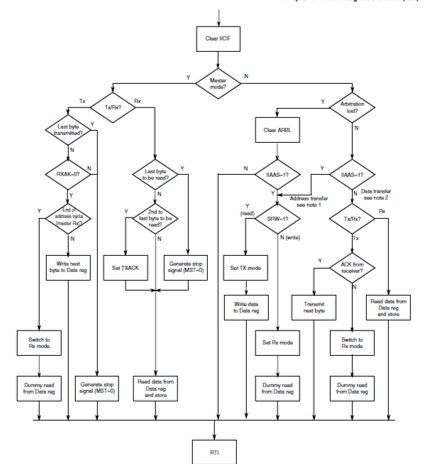

There is another way to implement this driver, it could be made using interrupt, this is done by setting IICIE bit in I2C_C1 register, as all I2C interrupt sources uses the same interrupt vector, you need to implement routine as shown on Reference Manual:
Basically, function to read, send/get ack and switch to master or slave are needed, you just need to follow the flow expressed in this routine or do a polling-specific routine according to your slave’s specifications.
If there is still doubts on I2C routine, you can run I2C example and see on oscilloscope exchanged-data between master and slave.
