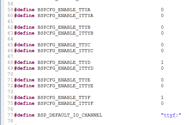

Hello Kevin,
Default UART is the one connected to OSJTAG USB connector, to use TWR-SER, change the user_config.h
Change this line:
#define BSPCFG_ENABLE_TTYD       1
And add:
#define BSP_DEFAULT_IO_CHANNEL "ttyd:"
And rebuild the libraries.
Luis

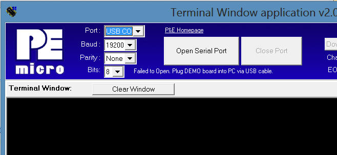

lmg
I'm having similar problems with Kevin.
CW10.4, MQX 4.0.1, TWRK60D100M.
I have been able to write, download, and debug some simple programs - both canned examples and my own programs.
But I cannot see anything from printf() statements in the code.

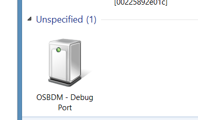

I have successfully updated the P&E software to osbdmens_arm.3121. When I plug the USB port in and look at my Win8 control panel, I see only the OSBDM - Debug Port; no CDC terminal as you say.
So it's not surprising that when I open P&E's Terminal Window application (v2.05) and attempt to "Open Serial Port" on USB COM, I get an error message: "Failed to Open, Plug DEMO board into PC via USB cable." (My Tower board is plugged in to a USB port of course.)
I have tried all Baud rates.
Here is what config.h looks like:
What am I doing wrong?

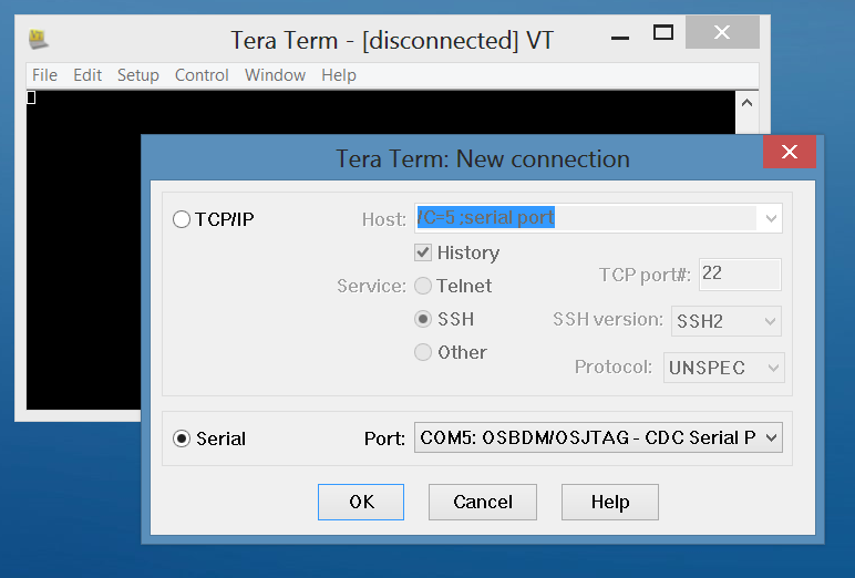

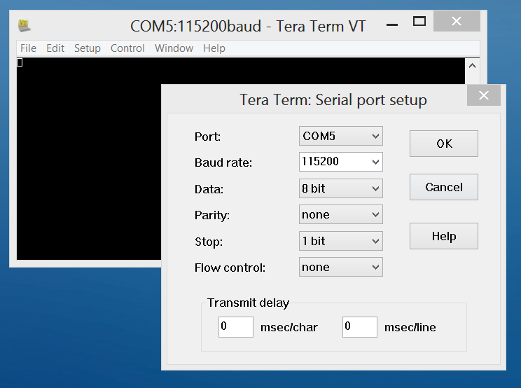

lmg
I think I've found a solution.
1. Download and install Tera Term virtual terminal.
       teraterm-4.78.exe from Download - Tera Term - SourceForge.JP
2. Start Tera Term. Cancel any windows that pop open upon start up.
3. Plug in TWR board USB connection. I'm using the one on the board itself, not the SER board.
4. In Tera Term, click File->New Connection.
5. Select the serial port that is the OSBDM connection. (I assume the com number may be different on different machines.)
6. Under Setup->Serial Port, make sure the settings are correct. I'm using the TWRK60D100M.
7. And it works! Results from printf() show on the Tera Term screen.
8. You can also go to Setup->Save Setup to make your selected serial port and baud rate the default. TERATERM.INI appears to be the default file that is loaded each time the program starts. If you do this, the connection is made automatically when you start Tera Term the next time - assuming the USB cable to the TWR board is plugged in. If the USB cable is not plugged in when you start Tera Term, you get an error message. You then have to click File->New Connection after starting Tera Term.
~LMG

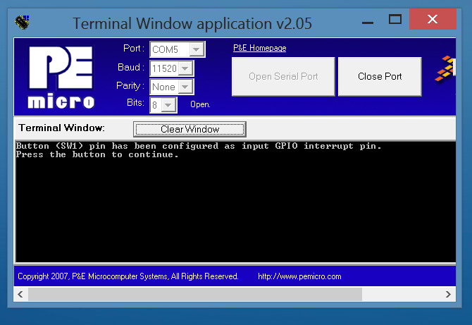

lmg
And another solution:
Now I know that the TWR board is talking to my PC on COM5, I tried P&E's virtual terminal.
And it works!
So I guess my problem was that I did not know where on my PC the serial port was going to show up. Tera Term helped because it showed me that COM5 was active.
Hope this helps.
