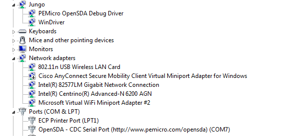

terry_lv
Hi Ray,
     Could you confirm that there is OpenSDA in your Device Manager?
     Thanks~~
Terry
