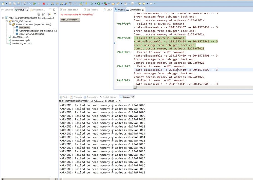

maksim_lipskiy
If that's what happened to step out of the Hardfault interrupt handler:
5,923 Views
mjbcswitzerland
Specialist V
If this is accurate, it is showing that the hard fault is due to your code trying to run in the memory area 0x79aff020, which is invalid. Why the code is trying to run from there will be due to a problem such as using a bad pointer to jump to, trying to handle an interrupt which has an invalid/random interrupt vector or returnîng from a sub-routine where the stack has been corrupted (and the return address overwritten with random data).
You will need to study your code to work out where the failure start from (if the error is consistent you can simply step through the normal operation until it fails) or use proven code to save needing to do such excercises.
Mark
5,923 Views
maksim_lipskiy
Thank you very much for your answer. I
I set a slight delay after the function sending data for UART and  hardfault inerrupt ceased !!!
