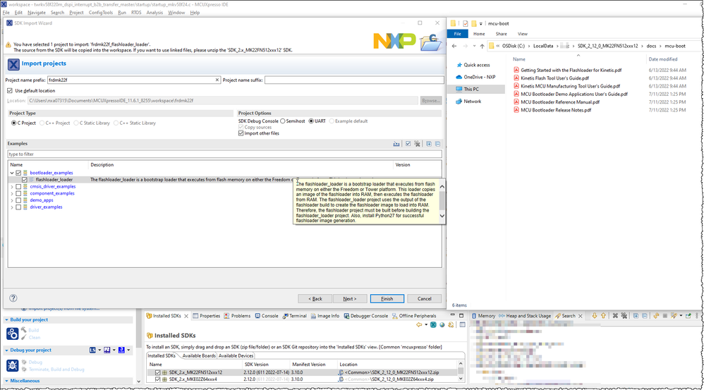

I'm developing a K22 microcontroller software. I need to have a bootloader, and i saw KBOOT version 2.00. I downloaded a copy on my pc, but I can't understand how to use it.
Somebody, Can give me some tips?
Where I can found a documentations  abaut it?
Are there, some kind of example, where it is possible to see I KBOOT works?

I have already downloaded KBOOT v2. My question is how to use it? How to create new project to implements a bootloader? And at the end How to include bootloader in a project?
I saw the documentation, but I didn't find an example of bootloader implemented with KBOOT.

Hi vdavi81_cefla,
Please select MCU_Boot when build SDK. The documents can be found in ...\SDK_2_12_0_MK22FN512xxx12\docs\mcu-boot
Build SDK for MK22FN512xxx12.pngBuild SDK for MK22FN512xxx12.pngDownload SDK Archive including documentation.pngDownload SDK Archive including documentation.pngflashloader_loader mcu-boot docs.pngflashloader_loader mcu-boot docs.png
