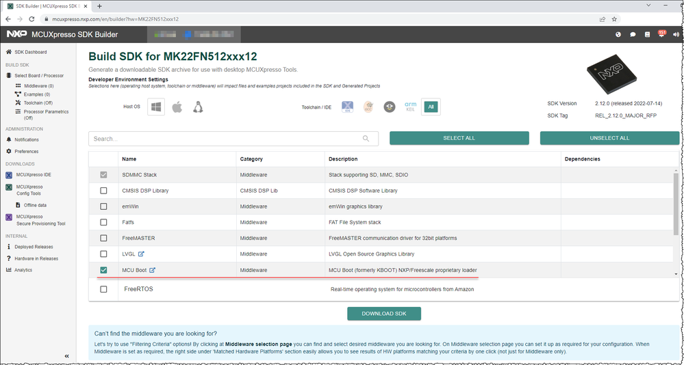

I have already downloaded KBOOT v2. My question is how to use it? How to create new project to implements a bootloader? And at the end How to include bootloader in a project?
I saw the documentation, but I didn't find an example of bootloader implemented with KBOOT.
3,826 Views
Robin_Shen
Hi vdavi81_cefla,
Please select MCU_Boot when build SDK. The documents can be found in ...\SDK_2_12_0_MK22FN512xxx12\docs\mcu-boot
Build SDK for MK22FN512xxx12.pngBuild SDK for MK22FN512xxx12.pngDownload SDK Archive including documentation.pngDownload SDK Archive including documentation.pngflashloader_loader mcu-boot docs.pngflashloader_loader mcu-boot docs.png
Robin
