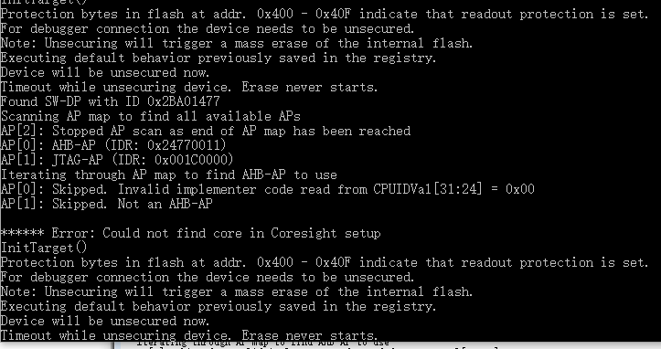

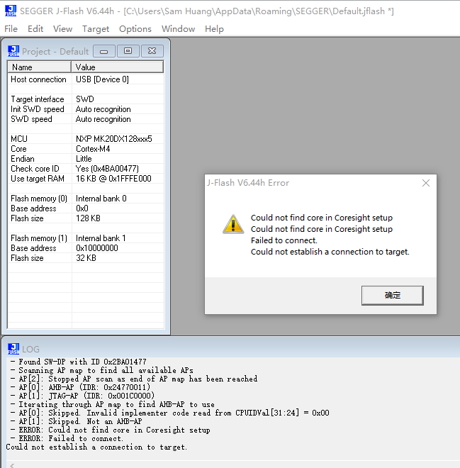

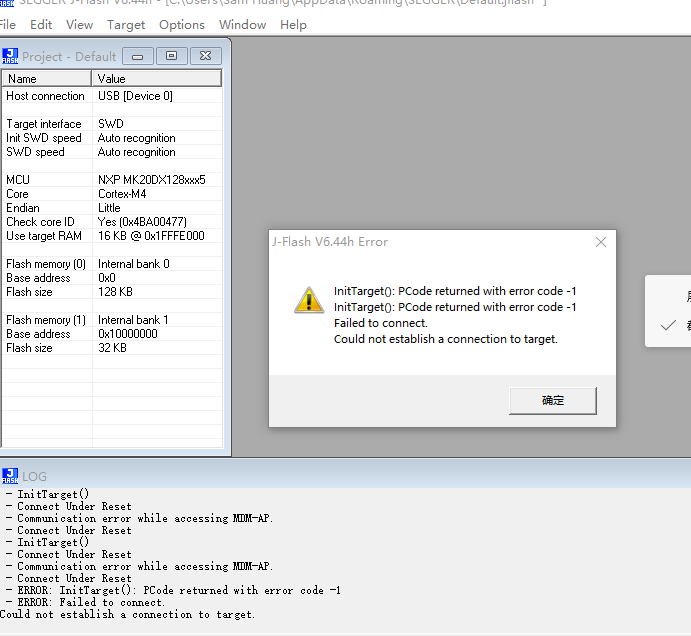

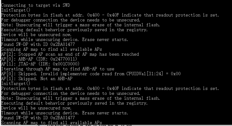

I  will use the SWD to download MK20DX128 ? How will  do it ?QQ图片20190704122752.pngQQ图片20190704122811.pngQQ图片20190704122821.pngQQ图片20190704122837.png

    Is your MK20DX128 board new? Or you protect your board?
    Please try to use the JLINK to do the mass erase at first.
   In the JLINK commander, when you select the device, please select the MK20DX128xxx<ALLOW SECURITY>.
  After connect, even it is failed, please input: unlock kinetis
    Can you unlock it successfully, then you can connect it again, can you find the ARM core or not?
   If you still can't unlock it, please check this post:
