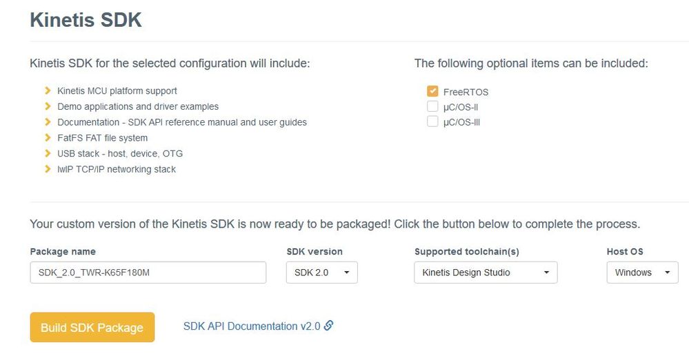

Then create and downlaod a software development kit (SDK) for your specific board:
Welcome to Kinetis Expert | Kinetis Expert
The SDK has all the example projects, sample code, and the drivers KDS needs to build projects for your board.  Pay attention to the details in the picture below.  If you plan on using KDS you need the have it selected in the "Supported Toolchains" drop down menu.
155896_155896.JPGbuildSDKforTWR65.JPG:

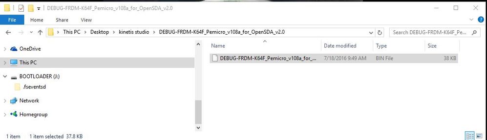

The TWR-K65 has a debugger built into it, that debugger comes with firmware installed on it.  I don't know if I did something wrong at first, but I could figure out how to load and debug a project on the TWR-K65, so I started installing different firmware to my debugger, which was a mistake.  I was able to debug a project with KDS and the TWR-K65 by loading the attached "DEBUG-FRDM-K64F_Pemicro_v108a_for_OpenSDA_v2.0.bin" file to the board.
To do this:
     1 - Unplug the board from your computer.
     2 - Hold down the reset button.
     3 - Plug the board back in while holding the reset button, you can let go after the LEDs start blinking.
     4 - You will notice a "BOOTLOADER" USB device show up in windows explorer.
     5 - Drag the DEBUG-FRDM-K64F_Pemicro_v108a_for_OpenSDA_v2.0.bin file onto the bootloader.
     6 - After the file is copied to the bootoloader, unplug the board, and then plug it back in.
     7 - To be safe, restart KDS.

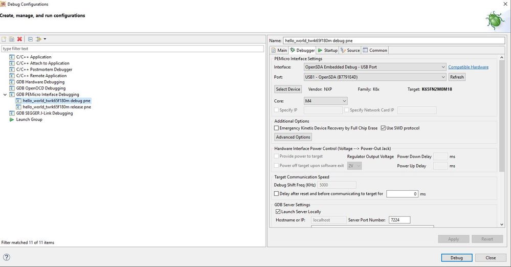

     1 - Run Menu -> Debug Configuration
     2 - Under the "GDB PEMicro Interface Debugging" option, select debug pne option.
     3 - Select the "Debugger" tab, and configure it like the photo below. 155925_155925.JPGdebugOptions.JPG
     4 - Press "Close"
     5 - Press the hammer button to build the project, then the debug button and KDS will launch debug mode.

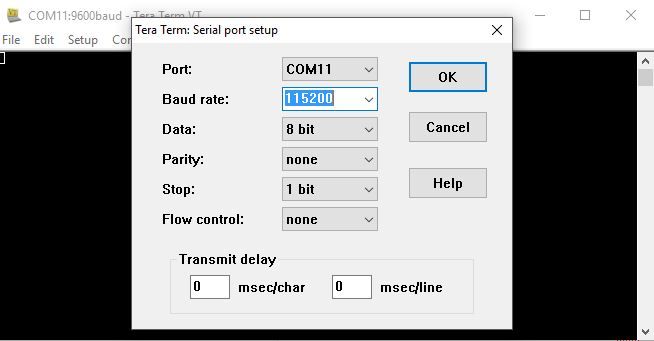

     6 - Now open a terminal emulator (I use Tera Term) and connect to the TWR-k65 com port using the settings below.            (COM11 is my board's COM port on my computer). 155926_155926.JPGcomsettings.JPG
     7 - Once you have established a serial connection to the board, go back to KDS and press the debug play button.
When you go back to your terminal emulator program you should see hello world printed to the screen.
