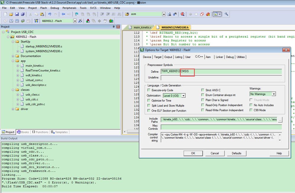

Currently using keil ide I am getting following error while trying to run any demo from USB stack
.\RAM\USB_CDC.axf: Error: L6218E: Undefined symbol asm (referred from main_kinetis.o).

Hi Karthik Poojary,
  Did you use the MDK project?
  If yes, please add CMSIS in the options define:
Then save the project, and build again, you will find the error have disappeared.
Wish it helps you!
If you still have question, please contact me!
Jingjing
