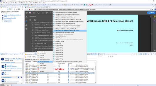

Check the MCUXpresso SDK API Reference Manual for the MKL25Z4 to get an overview of the available API functions of the FRDM-KL25Z SDK, here are some options to do this:
1 https://mcuxpresso.nxp.com/api_doc/dev/1364/index.html
2 Download the API reference manual after build an SDK from MCUXpresso SDK builder.
3 A cool feature of MCUXpresso IDE is that lets you open SDK documentation from a previously installed SDK.
