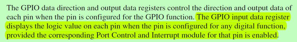

What should i expect if i read the logic level of MISO pin by the PDIR register (GPIOx_PDIR & 0xx),unless the MUX is switched to GPIO from SPI_MISO alternate function?

    I don't know which chip you are used, but as I know, our Kinetis K ,KL, KE chip all has the funtion which you need. It is when you configure the pin to other function, not the GPIO function,
you still can read the GPIOx_PDIR to get the pin logic value.
    Actually, in the chapter GPIO of our reference manual, it has detail description like the following:
    So, if you use the Kinetis K ,KL, KE chip, you don't need to switch to GPIO, just read it directly! I already verify it successfully!

Many thanks Jingjining,thanks for hightlighting the part that i missed to notice reading the datasheet
Forgive me if i did't mention what uC i was talking of,
it is about KL series
