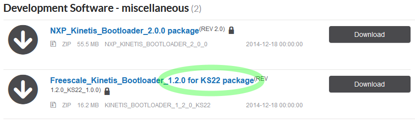

Is the full Kinetis Bootloader 1.2.0 package still available for download anywhere on the NXP website?
When following the Link to MCU Bootloader | NXP you can read "The legacy KBOOT downloads are still available on the MCUBOOT downloads tab."
But there is only "Freescale_Kinetis_Bootloader_1.2.0 for KS22 package" which lacks (at least) the sources for blhost.
I am looking for a "as small as possible" blhost tool for flashing a MKL13 device via UART from an i.MX6. Before starting to strip down the blhost tool from MCUBOOT 2.0, I wanted to have a look at the older version with less functionality.

mahi
Hi Jing,
would you please have a look at the MCUBOOT download page --> MCU Bootloader | NXP ?
There is only a 1.2.0 package especially for KS22. I agree, that most probably the blhost tool in there is not a special one. The problem is, that this package only contains the blhost binaries and no sources (validation directory is missing).
 Martin
