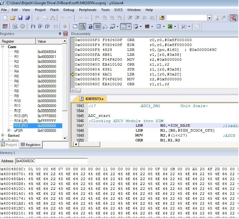

titan99bijou
Hi Rong,
Thanks for your views & time spent there. But seems the instruction is behaving as desired. Am using a Keil 4 Assembler & attached is the snapshot of the debugger at that instruction.It can been seen that the MOV R2,#(1<<27) shifts 1, 27 bits to the Left thereby activating the ADC clock.
Can some1 please check my Core,Bus & ADC Clocks are in range & within specifications?

egoodii
Senior Contributor III
Actually, the Cortex M4 instructions allow for 'somewhat more general' fixed values in addition to 'immediate 16 bits'.
From DUI0553A_cortex_m4_dgug.pdf:
Constant
You specify an Operand2 constant in the form:
#constant
where constant can be these (or for MVN [move negate] their inverse):
• any constant that can be produced by shifting an 8-bit value left by any number of bits
within a 32-bit word
• any constant of the form 0x00XY00XY
• any constant of the form 0xXY00XY00
• any constant of the form 0xXYXYXYXY.
How individual assemblers create the syntax to implement these different forms is probably 'implementation dependent'.
