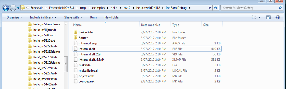

I am using TWR-K60N512 with PK60DN512Z VMD10 chip, and Codewarrior 10.5 IDE with MQX 3.8. Does Freemaster work in MQX 3.8? If so how do I enable its functionality in MQX, and load the project symbol file in Freemaster? I don't see a project symbol file (.map or .elf) in the workspace, is it loaded differently for MQX projects?

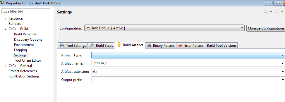

There isn't a 'list' folder in twrk60n512_Int_Flash_Debug. But there are files with '.afx', and '.afx.XMAP' extension, which is the right one?

Sorry, the default extention is afx in MQX 3.8 projects, you can change the properties of your project, to generate elf file.
Please refer to the properties, change the artifact extention from 'afx' to 'elf', then you can get the elf file
