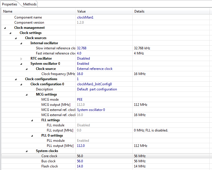

Using processor expert, I am trying to set up the microcontroller to run off of an external clock source. I think we have the processor expert settings mostly figured out, but for reasons that are unclear to me, we can't run the core clock at the MCG output frequency.
We are using the MK22F256VLL12. Here is the working configuration (note core clock speed of 56 MHz):
And here is the non-working configuration (note core clock speed of 112 MHz):

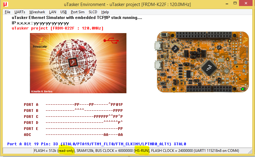

If you are using the K22FN256 you may need to configure the high speed run mode (maybe at a different location in the tool?).

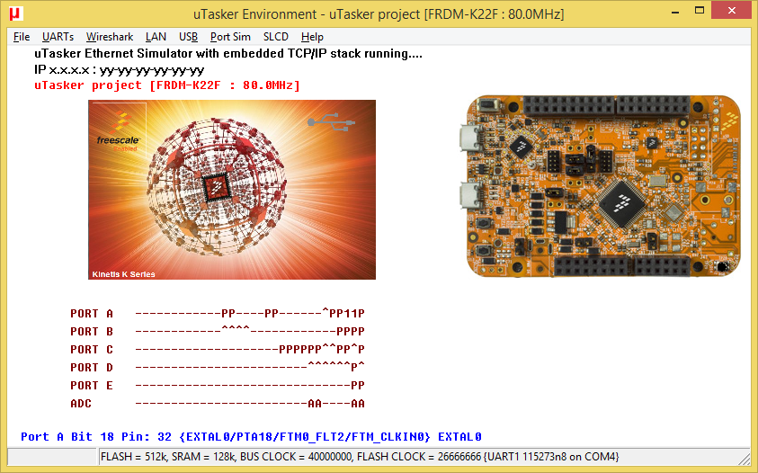

In the normal RUN mode the maximum specified core/system speeds are 80MHz and the bus clock needs to be <= 50MHz.
Flash can be <= 26.667 MHz.
If you configure high speed mode of operation you can then work at the full 120MHz core/system speed but you won't be able to program or erase flash in this mode.
Below are the optimal configurations for the K22FN256 in the two modes as shown by the FRDM-K22F running in the uTasker simulator:
RUN mode
High-Speed RUN mode.

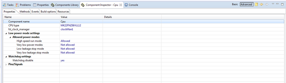

derekschumacher
I'm surprised I was able to run with the 56 MHz bus speed since that violates the <= 50 MHz rule in normal run mode. Anywho you are absolutely correct, I needed to allow high speed run modes from the CPU component:

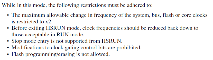

mjbcswitzerland
Specialist V
Derek
These are the HSRUN mode restritions. Otherwise you can use stay in that mode and use the full speed of the device.
