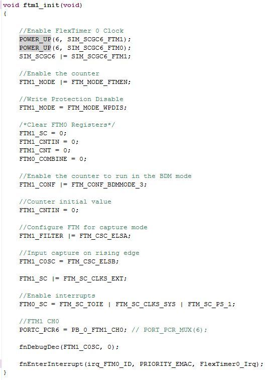

Hi i am trying to capture rising edge with a flextimer. I wont to calculate the time from one rising edge to the next one. I am trying in this way:

I change so i now have FTM1_MODE |= FTM_MODE_FTMEN;
but nothing happens

SergeMaslenniko
you need to configure FTM1_MOD with max value of the counter.
if 4096 is max value of your counter  FTM1_MOD = 4095
and FTM1_MODE you can configure in accordance with your task.
at least you did something like that: FTM1_MODE |= FTM_MODE_FTMEN;

I have now try to change my code to:
Its not make any sence to me any more
i have try to test the example FlexTimer_NVIC_IRQ and tryet to follow that example in som parts but i cant geth it
