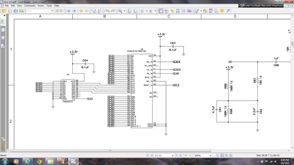

I have a custom board using a MK10FN1M0VLQ12. I have a 512K 16 bit Flash connected to the Flexbus. When I try to access the flash I get the following error "Target request failed: ARM GDI Protocol Adapter: Stop failed. non fatal error.". What would cause this error?  I am using a P&E multi-link bdm. Also I have the K10 address 1 connected to Address 0 of the flash for 16 bit access.  Is this correct?

Hi Dennis,
Would you please provide details on that issue? For example, the schematics of flexbus connection, the code to initialize the flexbus, and which instruction causing the issue you mentioned? Thanks for your patience!!

Kan the issue is cause when I try to read location 0x60000000.

Kan_Li
Hi Dennis,
It looks like you comment out AA bit configuration.
FB_CSCR0  =  FB_CSCR_PS(2) // 16-bit port
//   | FB_CSCR_AA_MASK// auto-acknowledge
//| FB_CSCR_EXTS_MASK  // ALE asserted thoughtout cycle
//| FB_CSCR_ASET(0x1)  // assert chip select on second clock edge after address is asserted
//| FB_CSCR_WS(0x1)// 1 wait state - may need a wait state depending on the bus speed
//| FB_CSCR_BEM_MASK // Byte enable enabled
and I didnt see the FB_TA is connecting with the external flash device, so that would cause problem during read operation as bus hangs during a transfer. Please enable this bit and try again.

c393
Hi Kan,
Thank-you for the Reply. I am not getting an error, but when I do a 16 bit I get back 0xC0FF when it should be 0xFFFF.
Thank-you

Kan_Li
Hi Dennis,
Did you change the Flexbus_Init()? If yes, please post it here for a review. Thanks for your patience!

Kan_Li
Hi Dennis,
I think it should be a timing issue, please try use | FB_CSCR_ASET(0x3) instead to see if it makes any difference.
