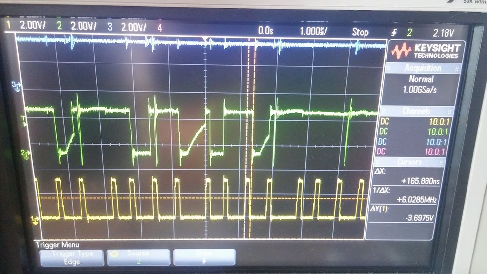

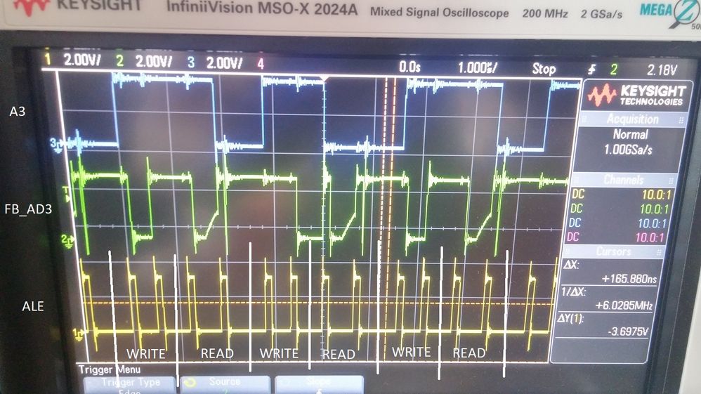

I use 74LVC574A to latch address on Flexbus on rising edge of ALE signal. However latching (and thus my interface to SRAM) works only if I delay a little the ALE signal (the delay is achived by connecting 330 pF capacitor between ALE and GND). The problem is that the latch sometimes and on some address lines latch old value of address lines, because the change of the address happens with rising edge of ALE signal and the new address value is missed by a short moment.
So, is latching supposed to be working with ALE directly connected to CP pin of D flip-flop? If so, then there is something wrong with my PCB. My Address/data lines are directly connected to 4 components - MCU, latch, SRAM and CPLD (Altera MAX V). The length of the lines is 3 inch max. Maybe too much capacitance on these lines, which delays signal on address lines causing latch of old values?

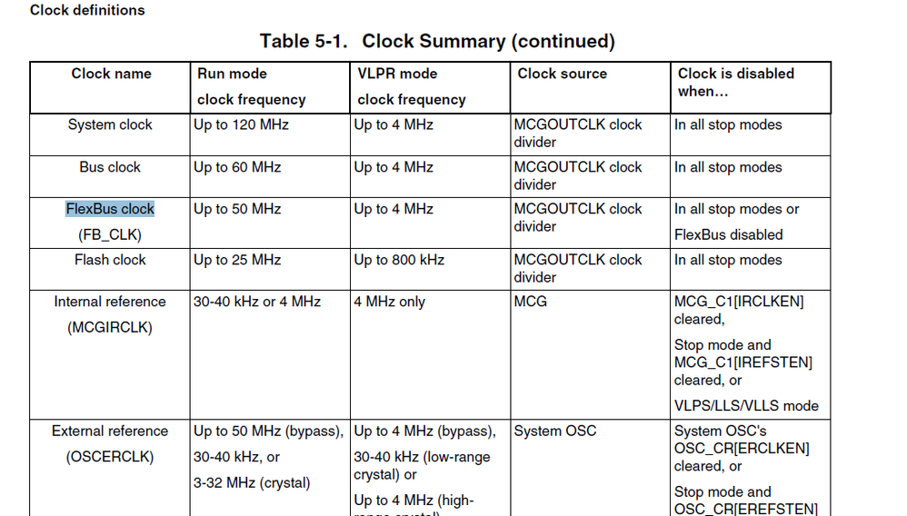

xiangjun_rong
Hi, Martin,
You did not mention the part number you are using, anyway, I suppose you use Kinetis for example K64.
Regarding your question, I suppose that the issue is related to the layout of the address lines, I give you two suggestions:
1)set the EXTS bit in FB_CSCRn, which will extend the address latch signal.
2)decrease the FlexBus clcok frequency. For example, the maximum FlexBus clock frequency is 50MHz for K64, if you reduce it to 25MHz, what is the result?
Hope it can help you
Xiangjun Rong
I post the clock distribution for K64:
3,942 Views
martindusek
Contributor V
Hi Xiangjun,
thanks for your reply. My part is MK22FN512VLL12. I divided Flexbus clock more, it is now 7,5 MHz. Still the same issue.
Without cap
Write/read to the same address with capacitor connected to ALE.
3,942 Views

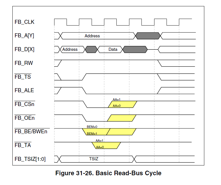

xiangjun_rong
Hi, Martin,
It seems that you select wrong D-type flip-flop, the FB_ALE is falling-edge trigger rather than rising-edge trigger, but it seems that the 74LVC574A is rising-edge trigger, you have to select a D-type flip flop with falling edge trigger. Pls check yourself.
Hope it can help you.
XiangJun Rong
FlexBus timing from RM of K22.
3,942 Views

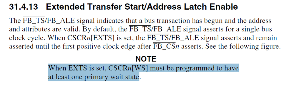

xiangjun_rong
Hi, Martin,
Firstly, you are right that ALE can be negated by setting FB_CSPMCR_GROUP1 = 2 (then you call the signal FB_TS) so there is no need to use falling edge triggered D flip flop.
Have you tried to set the CSCRn[EXTS] = 1? There is a note that "When EXTS is set, CSCRn[WS] must be programmed to have
at least one primary wait state".
If the above solution is invalid, as you said that the address track on the PCB is too long.
BTW, try to reduce the FlexBus clock frequency and check the result.
Xiangjun Rong
3,942 Views
