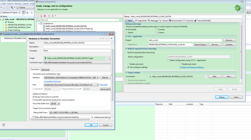

Hi  Leif Zars,
    Your flexmemory partition fails, it is because your partition is already exist.
    If you want to parittion the flexmemory again, you need to do the flash mass ease at first, then your older partition will not exit, and you can do your new partiotion.
    About how do mass ease,  if you are using cw, you do like following, just choose the "alway mass earse on connect‘.
  After the configration, then you downloader your code and run it again, you will partition the flexnvm succesfully.
Wish my answer will help you!
