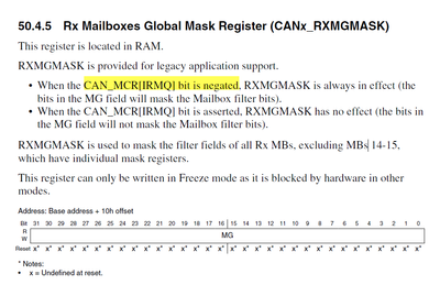

Regarding your issue of FlexCAN receiver, you can receive all packet no matter what the ID is, pls check if the CAN_MCR[IRMQ] bit is cleared. when the bit is cleared, the mailbox filter is valid.

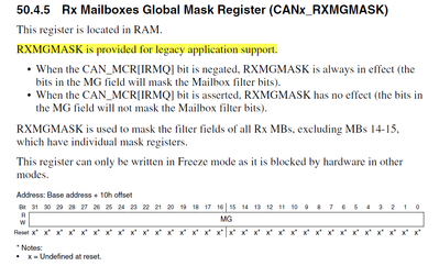

Sorry for misunderstanding you.
Regarding the CANx_RXMGMASK,CANx_RX14MASK and CANx_RX15MASK, the RM says that they are for legacy application support.
I have checked the original version of FlexCAN,  the original version of FlexCAN only have CANx_RXMGMASK,CANx_RX14MASK and CANx_RX15MASK, but does not have CANx_RXIMRx register group.
So I think it is okay to configure the CANx_RXIMRx register group for each mailbox, the CANx_RXMGMASK,CANx_RX14MASK and CANx_RX15MASK are useless, they are provided for legacy application support.
