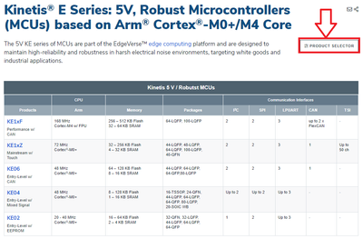

_Leo_
In the page of the KE Series you can see the module requirements you mention (Flash, SPI and CAN).
On the other hand, you can use the PRODUCT SELECTOR and filter in more detail. However for features like Flex Timer that supports dead time insertion it is necessary to refer to their respective reference manual or the sub-families I mentioned above.
Wish it helps you. If you still have questions about it, please kindly let me know.
