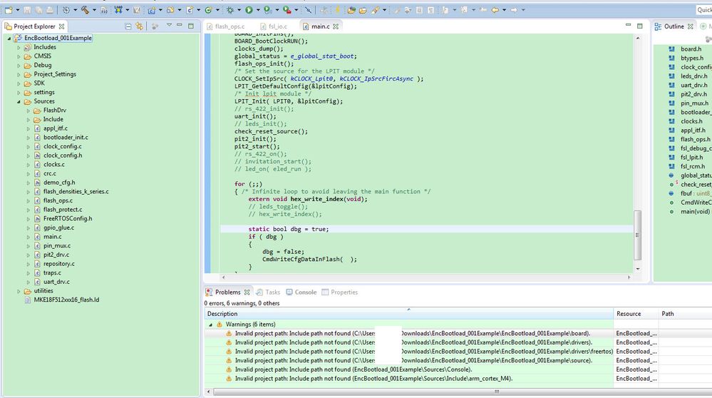

  I open your project with KDS, but there has some invalid project notes:
I find in your package, there's no board, drivers folder, any problems on your side?

Here it is the cleaned project.. Just a detail: I am using the JTAG not the SDA.

The project is made for a board using the same processor, there is no specific informations on the tower board. I have just deleted some specific files and adapted to produce the bug. It is working as is on the  TWR-KE18F board. The cleaning has left some path of the original project but they appear to be innocent.
I have now cleaned the project files manually and the warnings do not appear any more.
