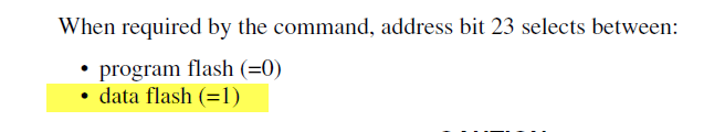

  How do you identify the PFLASH or DFLASH with the same function command(0x06 (PGM4))?
  Do you use this one?
I think you can write a simple project, just test your DFLASH write, read and erase without eeprom at first, when it works, then you can add the eeprom code again.

Question answered!  As kerryzhou‌ mentioned, the read and write addresses for the FlexNVM are different.
When setting up a FLASH command to write to the FlexNVM, bit 23 of the address must be a '1'.  Reads of the FlexNVM are from the standard addresses for the Kinetis part. In the case of the K20DX128VLH5, with the FlexNVM partitioned for 16K of data and 16K of EEPROM backup, the 'reads' are from 0x1000_0000 to 0x1000_3FFF but the 'writes' are from 0x0080_0000 to 0x0080_3FFF.

Hello kerryzhou‌.  That was the missing piece!  As stated in my original question the address of where to write the event is passed to the programming function but the 23rd bit was not being addressed.  If the passed-in address is at or above the base address of the FlexNVM (0x10000000) I now create the 'write' address with
ulAdd ^= 0x10800000;
This puts the write address in the correct FLASH command range for the FlexNVM...in my case between 0x800000 and 0x803FFF.
