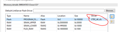

I am a starter on both MCUXpresso IDE and PEmicro debugger. The MCU I am using is Kinetis K64F512xx. I am not sure how to configure the flash driver if I use PE Multilink Universal FX debugger in MCUXpresso IDE. I downloaded an example project, and found the default configuration is FTFE_4K.cfx
Need I change this setting if I use PEmicro debugger or Segger J_link debugger?
Thank you for all supports.

Hi @caster ,
no, this setting is only for the Linkserver (McuLink, LPCLink, ...) debug connection. Both Segger and P&E use their own way and driver, based on the device name and options passed to the debug probe.
I hope this helps,
Erich

Hi Erich,
Thank you for the support.
Do you mean if I use PE or J-link debugger, I need to get the flash driver file from PE & Segger and configure it manually in MCUXpresso IDE?
Thanks.

You do not have to do anything: for J-Link and P&E this flash driver is ignored. Both Segger and J-Link have built-in flash drivers, it is done automatically.
I hope this makes it clear.
