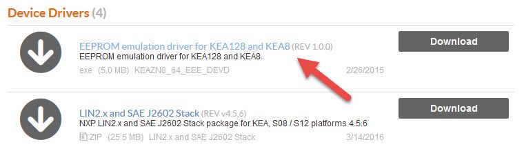

I want a example Flash Driver for KEA-128. My aim is to store some data in Flash and change it at run time in Flash and on next bootup I want the changed values to reflect in the code while bootup or after start itself.Please provide me this example with documents and example code :smileyhappy:

After had a brief look through the statement above, I'd highly recommend you to use the EEPROM Emulation Driver to achieve data storage of application variables that must be maintained when power is removed and need to be updated individually during run-time.
You can download the EEPROM emulation driver for KEA128 through the link as below.
KEA Reliable, Low-power MCUs|NXP

I think this official EEE (EEPROM emulation) driver for KEA128 can help you.
http://cache.nxp.com/files/32bit/software_tools/KEAZN8_64_EEE_DEVD.exe
