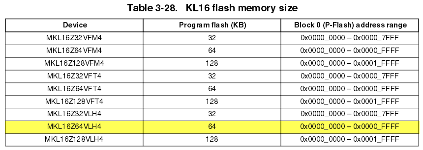

I'm trying to find what the address space is for this chip? It is the 64KB version.
Is the starting address 0x0000 and ending address 0xFA00?

Hello David Wathen:
You can find that information in the Reference Manual:
