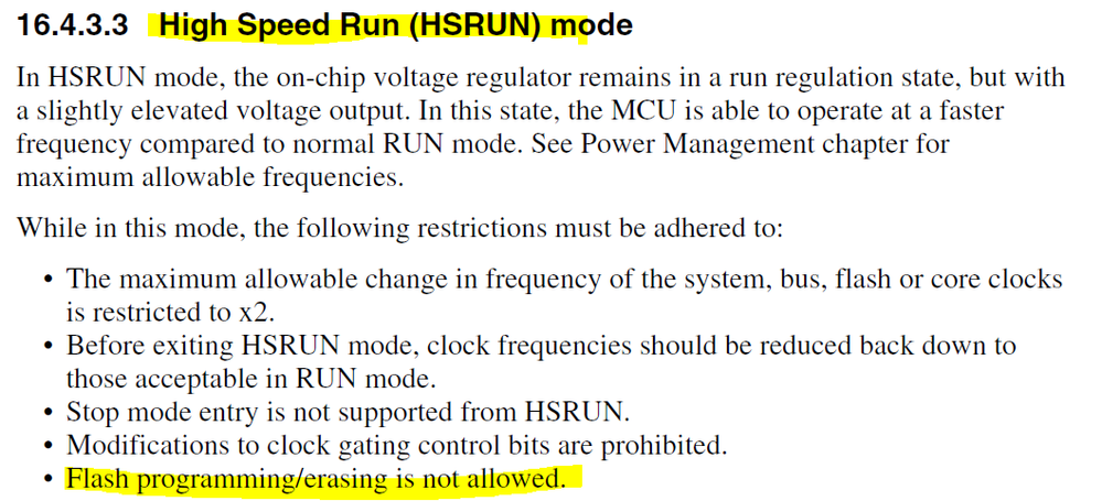

I'am currently working with K26f processor with KDS3.2 and KSDSK v1.3. Core clock is 180Mhz,Flash Clock is 25.71 Mhz as Processor Expert recommends...
I imported Flash Driver component into my project,selected the address to erase in internal flash,but FlashErase () returns me error 0x20 - Flash Access Memory.Following is my code after importing "Flash Driver Component" from Component Library.

result backs to me error 0x20 - Flash Access Error....
What's wrong here?

This will explain if you are in HSRUN mode. To program flash you need to be in RUN mode (max. 120Mhz CPU clock).

Thank you very much. It's working.

I was having kStatus_FLASH_AccessError while using FLASH_Erase command with Kinetis SDK 2.2 with a K02F microcontroller.
I was puzzled why it had such an issue until I saw your answer. Thank you very much. I really appreciate your this and other countless helps to the community.
