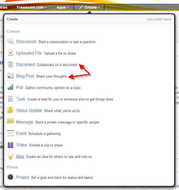

I'm glad to learn that you desgned the library of K60 and want to share it with others in community. To share it, you can click the Create(Fig 1), then select the Document or Blog Post to introduce your library is Ok.
Fig 2 shows the supported programmer of K60 and the linker is below. I think use evaluating board to program is available and the details you can refer to the User's Manual of the evaluating board.
3.jpg  Fig 1
