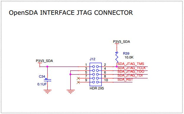

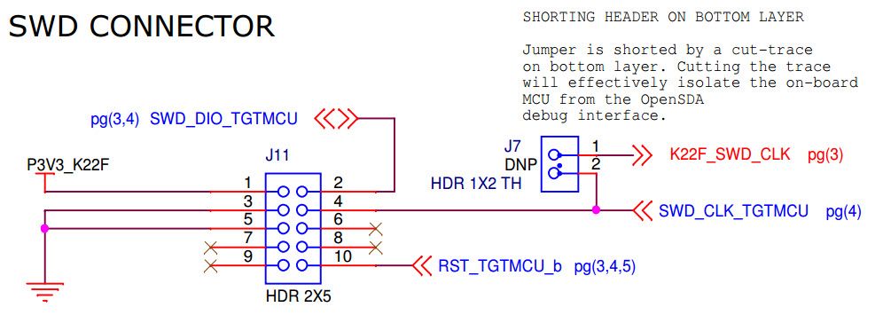

1. Can the both of boards return to the bootlaoder mode by holding the reset button while plugging in a USB cable into the OpenSDA USB port?
If the answer is no, you can use the J11 (Fig 1)with the external debugger without using the OpenSDA interface, and you also can use the OpenSDA interface debugger connector(Fig 2) to program the CMSIS-DAP Bootloader application to the K20 by referring to OpenSDAv2 .

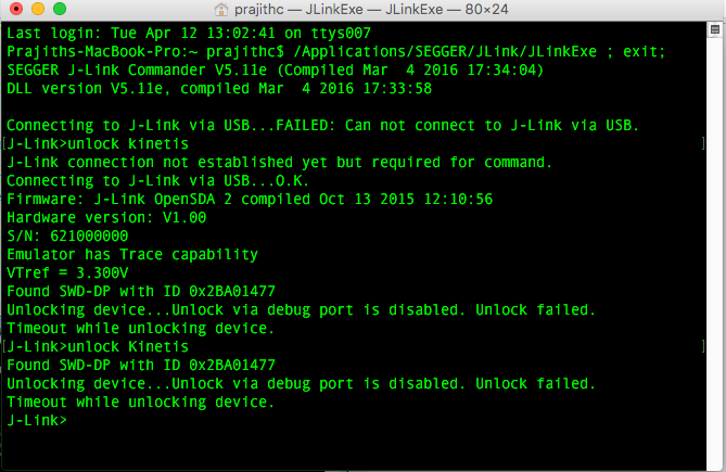

         Thanks for your reply. It is not possible to try OpenSDAv2.1 Firmware method on Board-1 as the board is not responding to Rest pin signal and not coming up in Bootloader mode. Please let me know next step for this board.
          Board-2: I could download OpenSDAv2.1 Firmware into it but KDS_3.0.0 throws error when tried launching debugger (Run->Debug). Tried launching debugger from different programs as well, but same error.
          Tried Segger J-link as well https://mcuoneclipse.com/2014/10/05/unlocking-and-erasing-flash-with-segger-j-link/ , but ended up in following issues,
     Could you please explain the root cause of this issue? Please let me know next step.

The document below illustrate the thoroughly steps to implement the OpenSDA.
And I think the OpenSDA bootloader firmware may be damaged, however you also can reprogram the OpenSDA bootloader firmware to K20, as the OpenSDA is open source.

Board1: "Flashing the bootloader will require an external debugger, such as the Keil ULink programmer or Segger JLink."-I do not have external debugger with me. Any other options?
Prajith
5,674 Views
jeremyzhou
Hi Prajith,
Unfortunately, it can't be programmed without using the programmer.
Ping

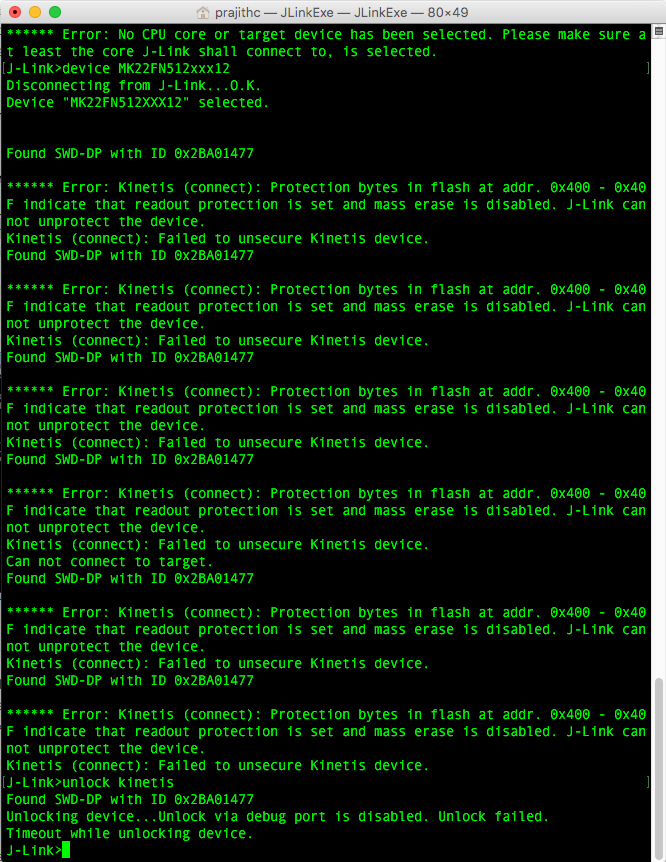

     From further debugging on the second board using Segger command line utility shows that the Flash got secured and
Mass erase is disabled. This is the worst situation, as per Reference manual the only way to recover the board is by Silicon replacement. Please find the below text copied from Device Reference manual (K22F Sub-Family Reference Manual , Rev. 3, 7/2014 ).
9.13 Debug & Security
When security is enabled (FSEC[SEC] != 10), the debug port capabilities are limited in order to prevent exploitation of secure data. In the secure state the debugger still has access to the MDM-AP Status Register and can determine the current security state of the device. In the case of a secure device, the debugger also has the capability of performing a mass erase operation via writes to the MDM-AP Control Register. In the case of a secure device that has mass erase disabled (FSEC[MEEN] = 10), attempts to mass erase via the debug interface are blocked.
     It looks like this issue is common in K22F controller as I'm seeing same issue in two of my custom boards also. Please find the error message from OpenOCD below,
Error: Cannot access device, device is secured
Info : Mass erasing a device will unsecure it until the next reset. To permanently unsecure, mass erase then flash a program containing an appropriate flash configuration field.
