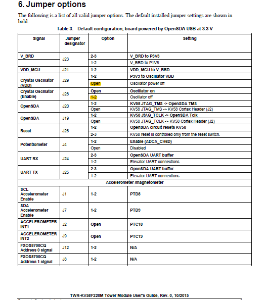

Hi Zhijun wu,
1. Please check the default board configuration.
    You can refer to TWR-KV58F220MUG.pdf in the TWR-KV58F220M-QSP
    But take care,  the TWR-KV58F220MUG have a error about J29 and J28, J29 should be open, J28 should connect 1-2.
   Please make sure your board's configuration is in default.

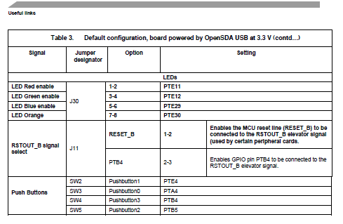

zhijunwu
hello Kerry,
I reuse CMSIS-DAP fireware to download promgram ,but "reading CPU status failed " problem is also exist.
I following the default  jumper setting :
in the file "TWR-KV58F220M Quick Start Guide":
in the file "TWR-KV58F220M Tower Module User's Guide":
and change the J29 to off(open) (you said "the TWR-KV58F220MUG have a error about J29 and J28, J29 should be open, J28 should connect 1-2.")。
following picture is the real jumper setting in my twr-kv58f220:
is this problem a other hardware or software error?

kerryzhou
Hi Zhijun,
  This problem is also relate to the IDE, MDK project have no problem, it seems just IAR project have this problem.
  You also can try to use CMSIS DAP with MDK project.
Kerry
