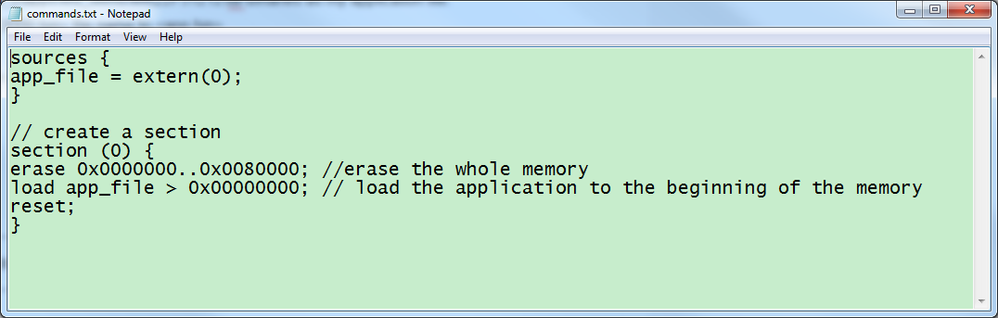

The command file sent to build the SB file with my application is quite simple:
sources {
app_file = extern(0);
// create a section
section (0) {
erase 0x0000000..0x0080000; //erase the whole memory
load app_file > 0x00000000; // load the application to the beginning of the memory
reset;
This is how I create the SB file:
elftosb.exe -o app.sb -c commands.txt app.bin

3> I use the same command file and named to <commands.txt>
4> After that, using [elftosb.exe] tool to generate the attached <app.sb> file.

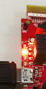

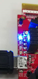

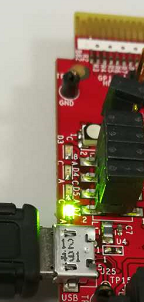

I check the TWR-K22F120M board, the boards leds start to blink alternately.
The reset command works as expected.
